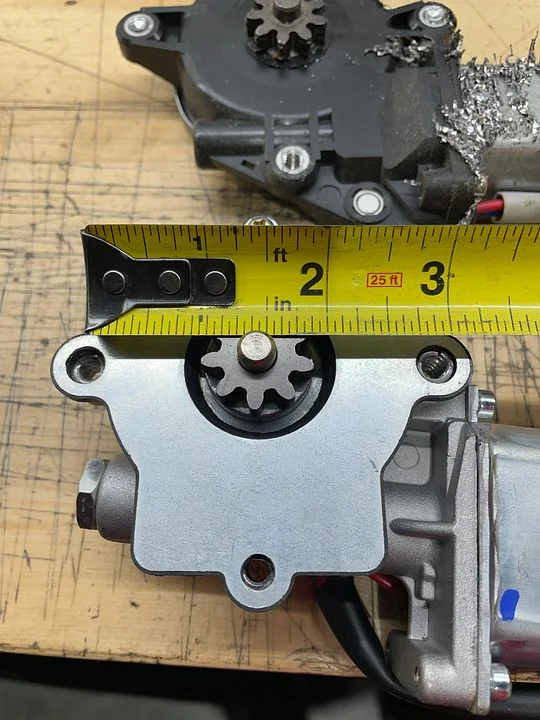

Mine was getting very slow up and down.
Ordered a new one from LMR. Part number E1ZZ-6623394.
Description - 79-93 Door Window RH

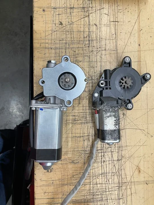

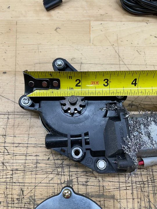

Pulled my old one out, it was already some cheap aftermarket.
Went to put new one in but holes are not the same, don't line up.
See pics.
Why is this different?
LMR seems to only carry the one I have, so no alternative.

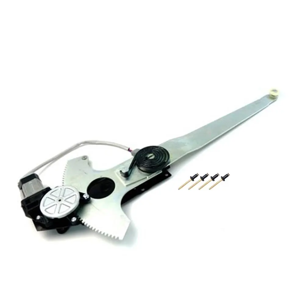

From my research -
It appears a previous owner purchased this window regulator replacement kit from LMR.
Notice the motor in that kit looks just like my defective one, but not like the new replacement.

Do you have a stock or OEM-like window regulator as well?
LMR states in their notes: "Window motors will ONLY bolt up to factory window regulators. Will not mount to aftermarket window regulators utilizing a different bolt pattern."
First my drivers motor went(it was original one) then two years later the pass.side went out, I took old one to ?autozone,pepboys,or oh oh ohreillyes,and they sold me ones that fit perfect with a lifetime warranty.
