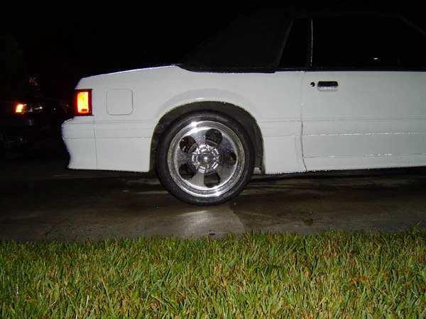

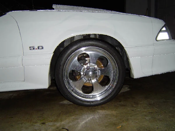

i want to know if you guys think this will rub...
its a 91 GT Convertible with
18inch EAGLE 212's on it
Tire : 245/40/18
and if you dont think it will, which springs should i get? I heard convertibles use a different kind of spring??? let me know guys... Thanks alot..

Will it rub? Depends on a few things. Do your wheels stick out or are they flush with the fenders? How stiff your shocks, struts and springs are will also make a difference. I don't know about all spring companies, but H&R makes seperate springs for convertibles.
Definately get springs made SPECIFICALLY for a vert!!! The reason I say so is that our verts have been somewhat reinforced straight from the factory (windshield area,body bracing) to protect us in the event of a roll-over. This reinforcement results in added weight up front that is why suspension companies make a different spring rate for verts. Check my sig to see what I've installed so far, I'm very happy with my set-up :nice:

I have Eibach lowering springs on mine, with 235/50/18 and I have no rub. I have not rolled the fenders either. There is not even any rubbing on the autocross course, however, I do not own a convertible if that makes any difference. Oh, this is on crappy worn out stock struts/shocks too. I would say that you are pretty safe.

I thought that the reinforcements were in the rear, and that the verts had stiffer springs in the rear? After all that is where they lost the roof. But then again I don't own one so I guessing.
Mo' Town
i have a vet and it is heavier in the back for sure than a non vert, me and my buddy have essentially the same car except mines a vert and his isnt, and with the same springs mine sits a good bit lower in the rear than his, i have eibach sprotline springs and have been very happy with them.
Ryan
I know for a fact you have to use springs specif for a conv, The rear of the car is very heavy and will make regular (non convert) mustang springs sag.... I tried it.... Mine sits like sh-t!! almost 1 inch lower in the rear But It makes launching a little better.....
