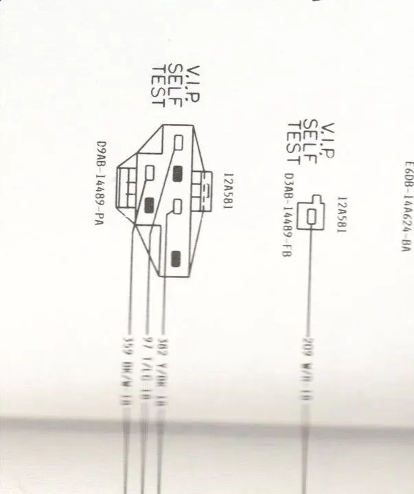

So my car doesnt have an OBD1 plug.. It looks like it may have broke and the last owner just let the wires hang. I got 2 plugs from the junk yard, one with 5 wires going into it and one with 4 wires going into it. Neither match the wires I have, I can only find 3 loose wires in my engine bay where the OBD1 should be.
Can someone post a picture of the plug and wires so I can see where each color goes to?

Your OBD1 plug should have one 6 pin connector and one 1 pin connector. Lemme see if I can upload a pic...

Yeah, I have that.. I just need to know what slot each color wire goes in to...

Sorry but the internet on my phone has been down for 3 days. No can do. What year is your mustang? I might have a wiring diagram for it at the shop.

I know for a fact that I have the wiring diagram for an 87. I'll be going out there in about two hours. I'll grab it when I'm there.

Here you go.

Thank you so much, this is a great help!
