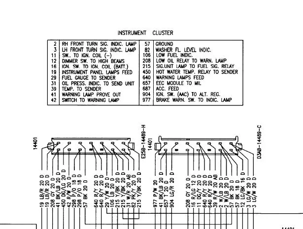

Jekyl New Member Mar 31, 2005 93 0 0 Calgary AB Jun 12, 2005 #1 Jun 12, 2005 #1 Can some one please post a wiring diagram for instrument panel lights. I am trying to hook up my tach and cant figure out what wire to splice into to get the light on my tach to work. Someone posted it before but I cant find it. Thanks
jrichker StangNet's favorite TOOL In Remembrance. Thank you for your contributions Mar 10, 2000 27,512 2,813 234 Dublin GA Jun 12, 2005 #2 Jun 12, 2005 #2 Hope this helps... Attachments Instrument Cluster wiring.webp 38.2 KB · Views: 133
