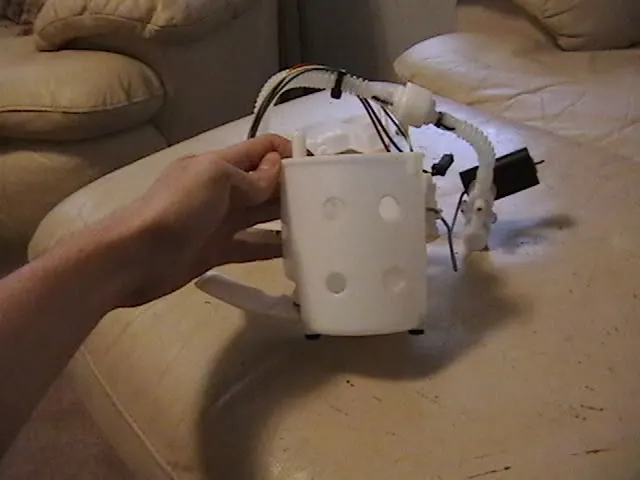

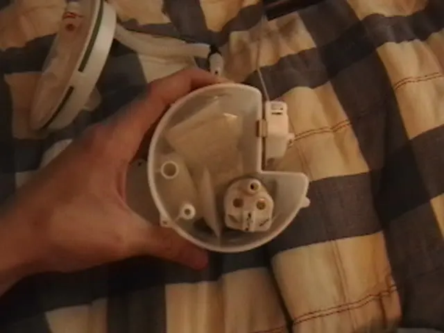

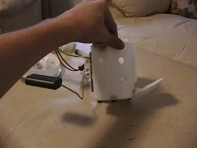

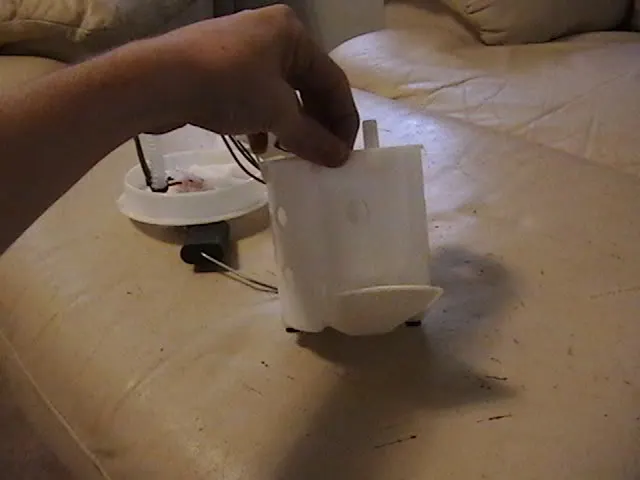

You need to drill a few 1/2 or so size holes mid way in the stock basket, cut your hot/ground wires that connect to the stock pump and solder on seperate female ends. The stock pump has a plug type setup, but the GT pump has the + and - a mile away from eachother compared to stock...so the plug wont work.
Remove the plastic case from the GT pump, and remove the long black hose that comes with it to. Then it should fit right into your basket....but you will need to notch the hat that connects the outlet of the pump to your fuel line to clear the (negitive) terminal/post on the GT pump...you will also need to make a 1/4 inch or so spacer that goes between the hat and the top of the basket to preven the hat from setting all the way down like it does stock.
Reason being is that the GT pumps spout is not the same size all the way down like the stocker, as you can see in this photo I took
So basically if you push that fat end TOO far into the hat, it pushes past the metal seal in the hat and will not beild pressure....its important to NOT push the hat all the way down over the GT pump. Thus the spacer(s)
hope that helps adrenln
Here are some pics of it in the basket.
and the holes I drilled.
