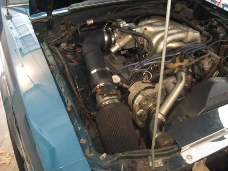

You can as long as its before the regulator (depends on if u using stock fuel rails etc) I have my fuel sytem set up with edelbrock rails so i have my regulator and fp guage mounted up by where the stock air box would of been. So yes you can if ur not using the stock set up and are able to get the guage before the regulator.
Not sure which side is the return (guessing passenger side?) but this is how mine is set up:
