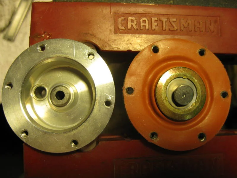

Sorry, late to the party here. Went through all this over 10 years ago. The only FPR that will work with the Walbro 255 high pressure (GSS 340, 341, 342) is the Kirban. Even with that one, the return orifice inside the FPR can be drilled out slightly (the center hole). Still won't go lower than 40psi with the vacuum line off. Also, it's the only FPR with a return line check valve (also called anti-drain back) inside the FPR. They used to put them inside the pump, but no more. You can see the check valve in the center of the diaphragm, there's a little spring behind it. With the Megasquit, you can run 50psi, but you have to change settings to account for it. Result is less duty cycle on the injectors at idle.
