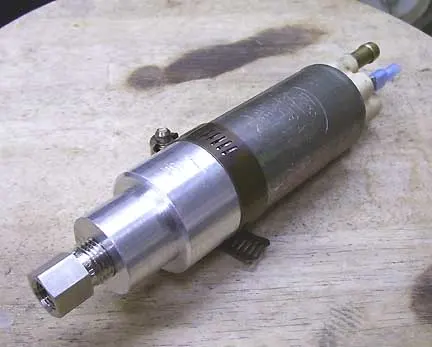

65ShelbyClone Founding Member Sep 9, 2000 4,675 38 119 Antelope Valley, SoCal Aug 23, 2007 #3 Aug 23, 2007 #3 Actually you can; I have done it. The problem is that it's completely impractical and unsafe. I do not recommend doing it. The one I modified was on a turbo Briggs & Stratton engine of all things. I never would use it on a car or something I couldn't easily bail out of. Attachments fuelpump.webp 19.3 KB · Views: 101
