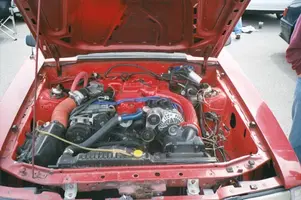

I think the hardest part of that swap would be the wiring. I saw this one a few years back, it's a fox with a supercharged 3.8 in it:
attachment.php
The wiring was an absolute rat's nest though. Looked totally hacked. You can see some of it in the pic.
