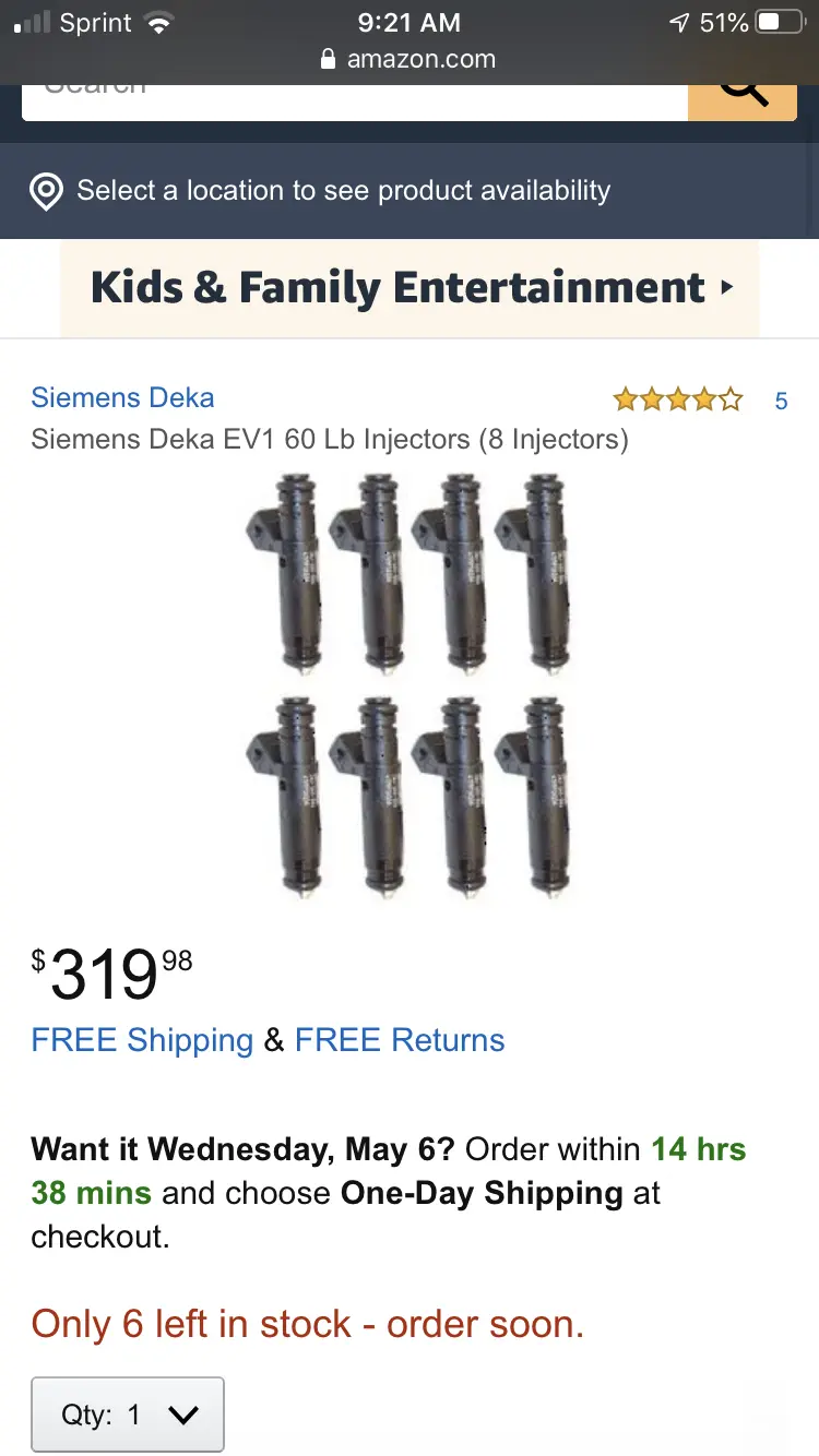

Apr 28, 2020
#11
  • Apr 28, 2020
  • #11
Thoughts on these?
mustang70
Nov 15, 2001
2,445
48
San Diego
Apr 28, 2020
#12
  • Apr 28, 2020
  • #12
If they're legit SD 60lb injectors I'd say you're good. I've tuned with them on a couple different set ups in the past and they worked really well.
