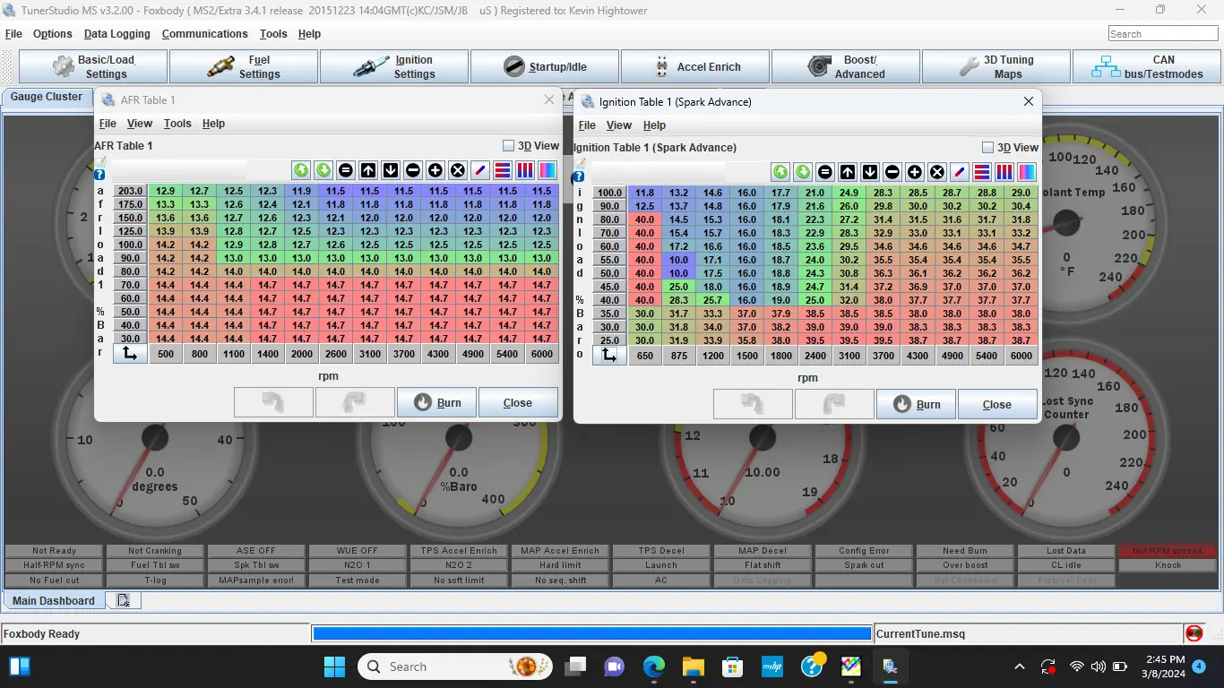

Hey everyone, I’m new here so be easy. I just picked up my first Foxbody. It’s a 93 GT with 347 stroker. I’m having some idle issues with Microsquirt and have no idea where to begin. I did a datalog with it idling, and also when I hit the throttle it just wants to fall on its face after RPMs drop back down. I don’t know how to get it to the point where I can give it fuel/come to a stop, without it just wanting to die. I’m new to Microsquirt/Tuning as a whole but want to learn. I can upload a datalog, show my fuel/ignition tables/ whatever is needed. Thank you.

The IAC duty cycle is pretty high, I'd recommend opening the throttle stop screw slightly (calibrate TPS after) to bring it down to 30-35 at an idle.
If you'd prefer not to adjust the throttle stop screw, calibrate the TPS--currently reading -0.6. Then adjust the idle initial values table, it currently drops well below the number recorded at a stable idle. This needs to be slightly higher than normal idle duty cycle, try 52-55 range and tune accordingly.
You have 2 ignition timing tables and table switching is turned off. Table 1 has crazy swings in commanded timing, Table 3 timing table looks good. Make this one your primary or enable table switch.

ive made some adjustments on timing table 1, i havent touched anything on timing table 3, im brand new to this. im not sure how to go about the table switching and making 1 or the other the primary. ill watch a few more videos and see if i can get it figured out. thank you for the advice

so the idle pwm is set to 10? is that what your seeing? i did calibrate my tps today before i did anything with the car. i had to get my timing set with the trigger wizard. im trying to understand what your saying. i havent really changed much in the fuel/ignition tables. i think i need to sit and watch some videos on idle values table etc...im kinda learning this all as i go. thank you.
Save table 3 and then load the settings when table 1 is open, essentially copy and paste.
The Idle duty cycle is currently at 49.8 at target idle RPM. Open the idle initial values table under the startup/idle tab. Bring the lower values up.
