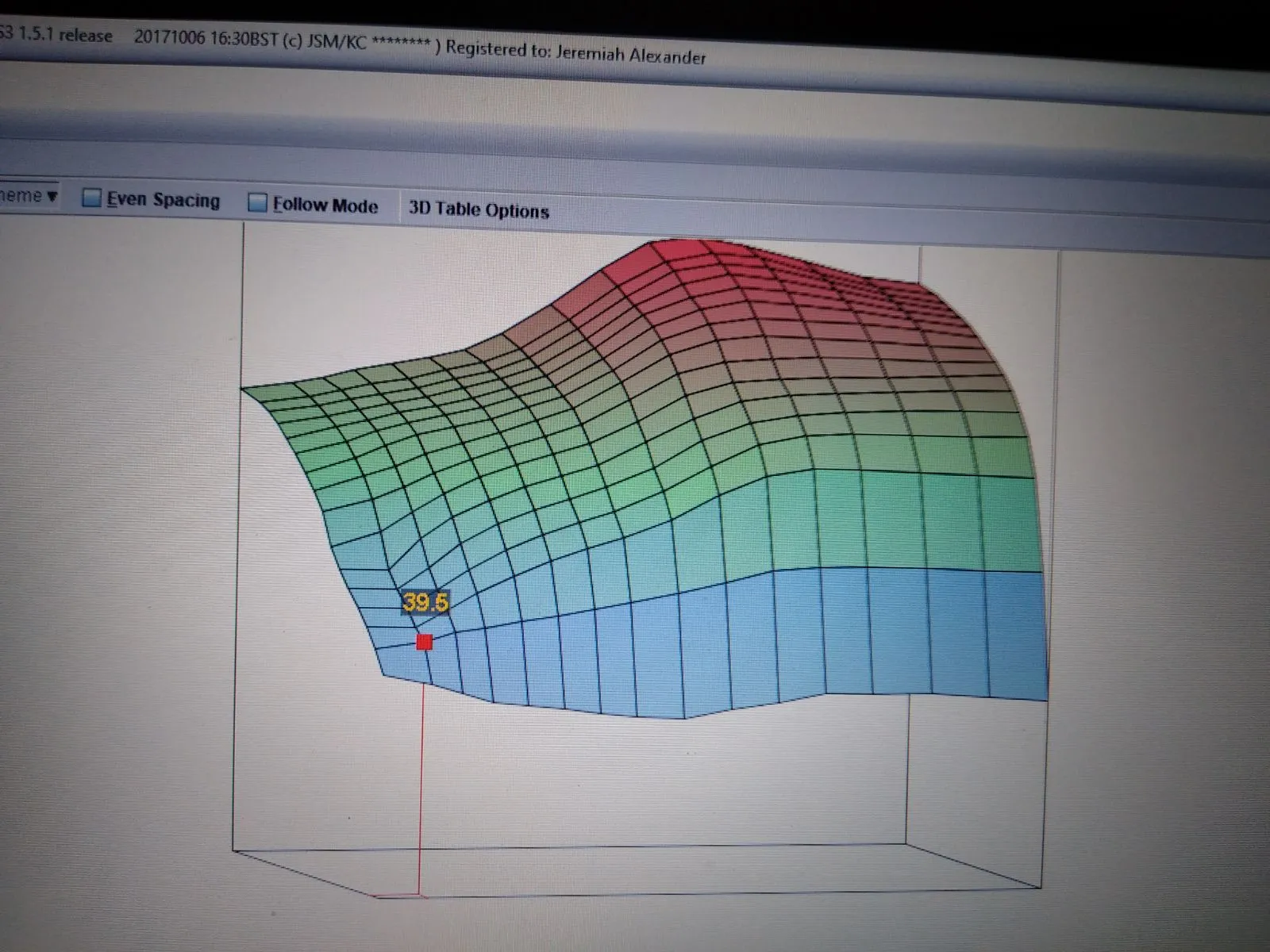

Is anyone willing to look over my tune and see if there's anything that they're seeing that isn't looking right? Also I cannot figure out idle, it's idling high and then after driving for a while it will idle down where I'd expect. But between there it will consistently bump up a bit higher than I'd expect.
HCI, supercharged, deka 80lb injectors, vented valve covers
Verify that your idle control is set for closed loop. Turn on idle advance.
Your AFR's are very rich at cruising and your VE table needs some attention as well. All the transitions should be smooth, linear.
Here's my current VE table for comparison.
