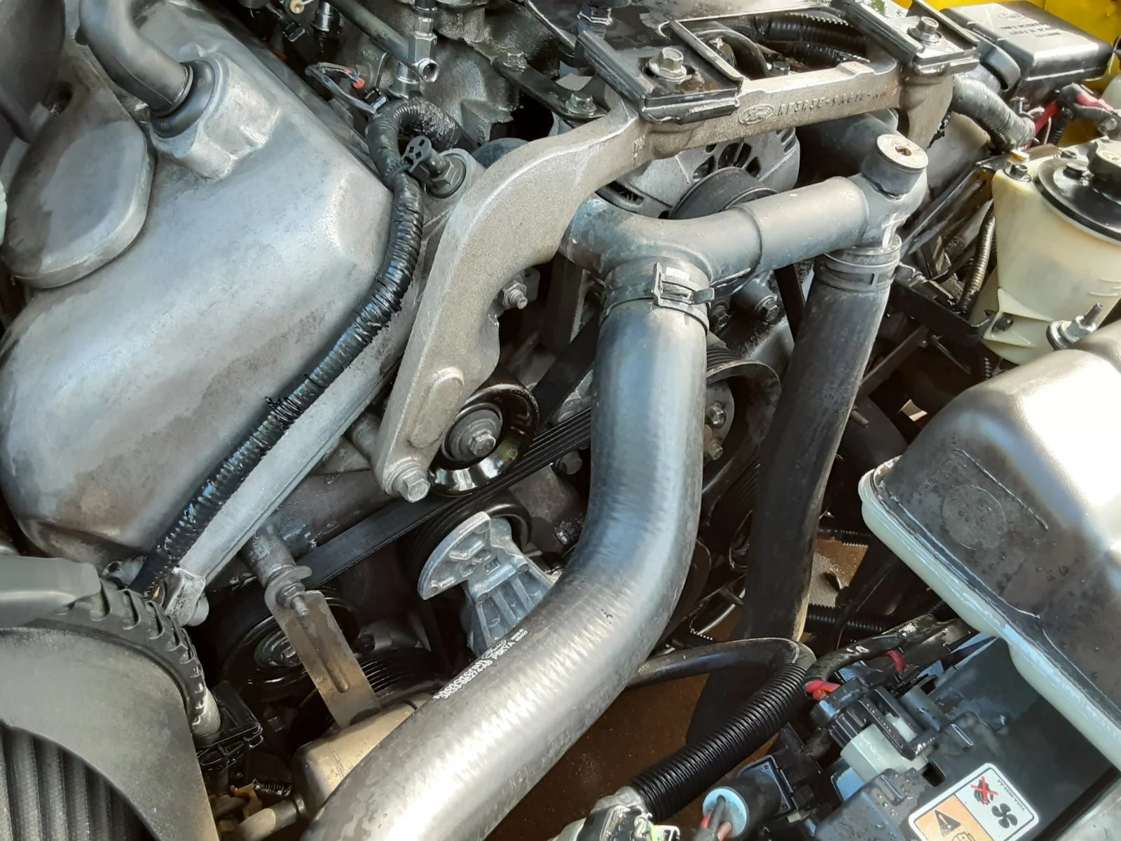

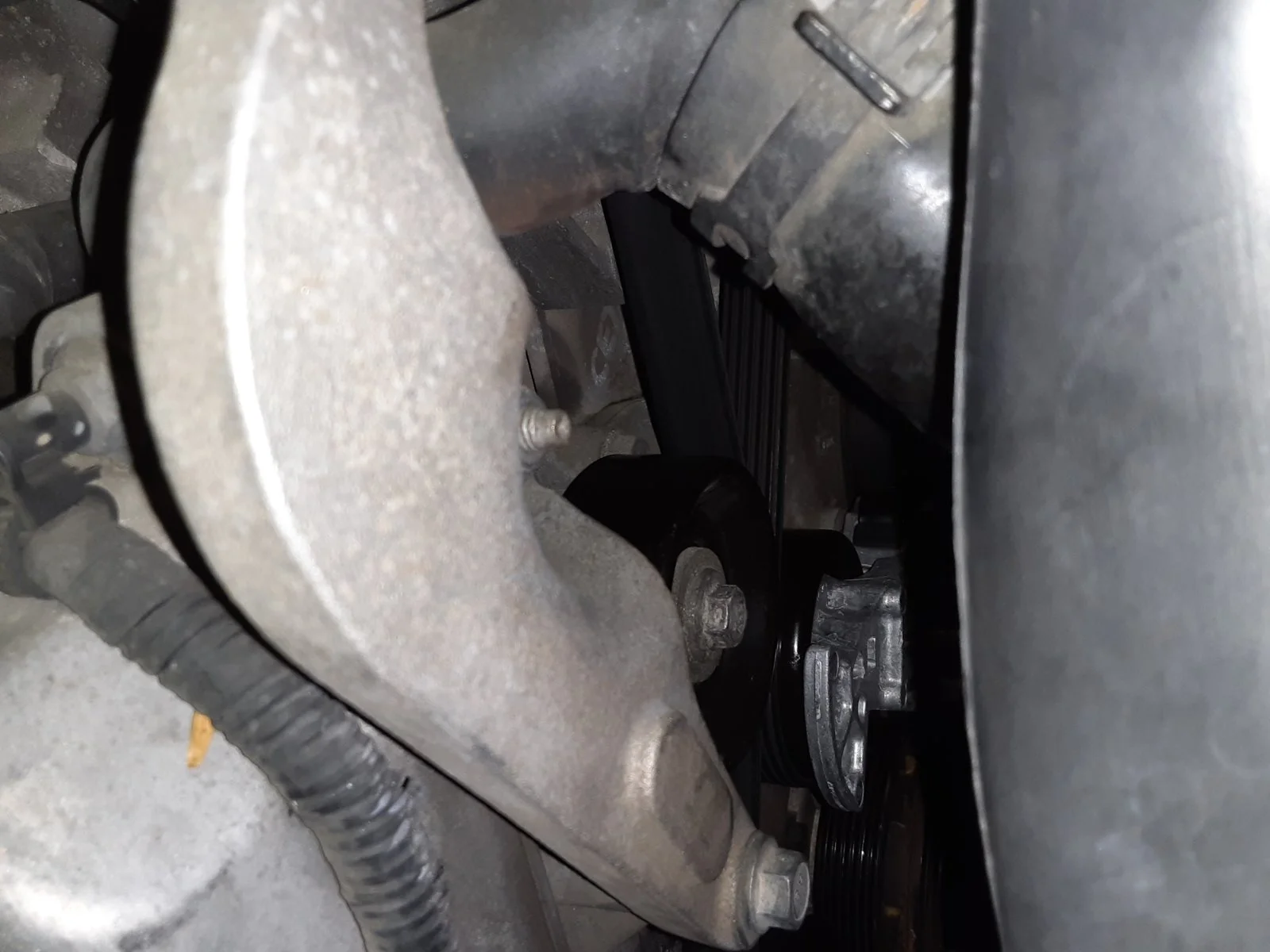

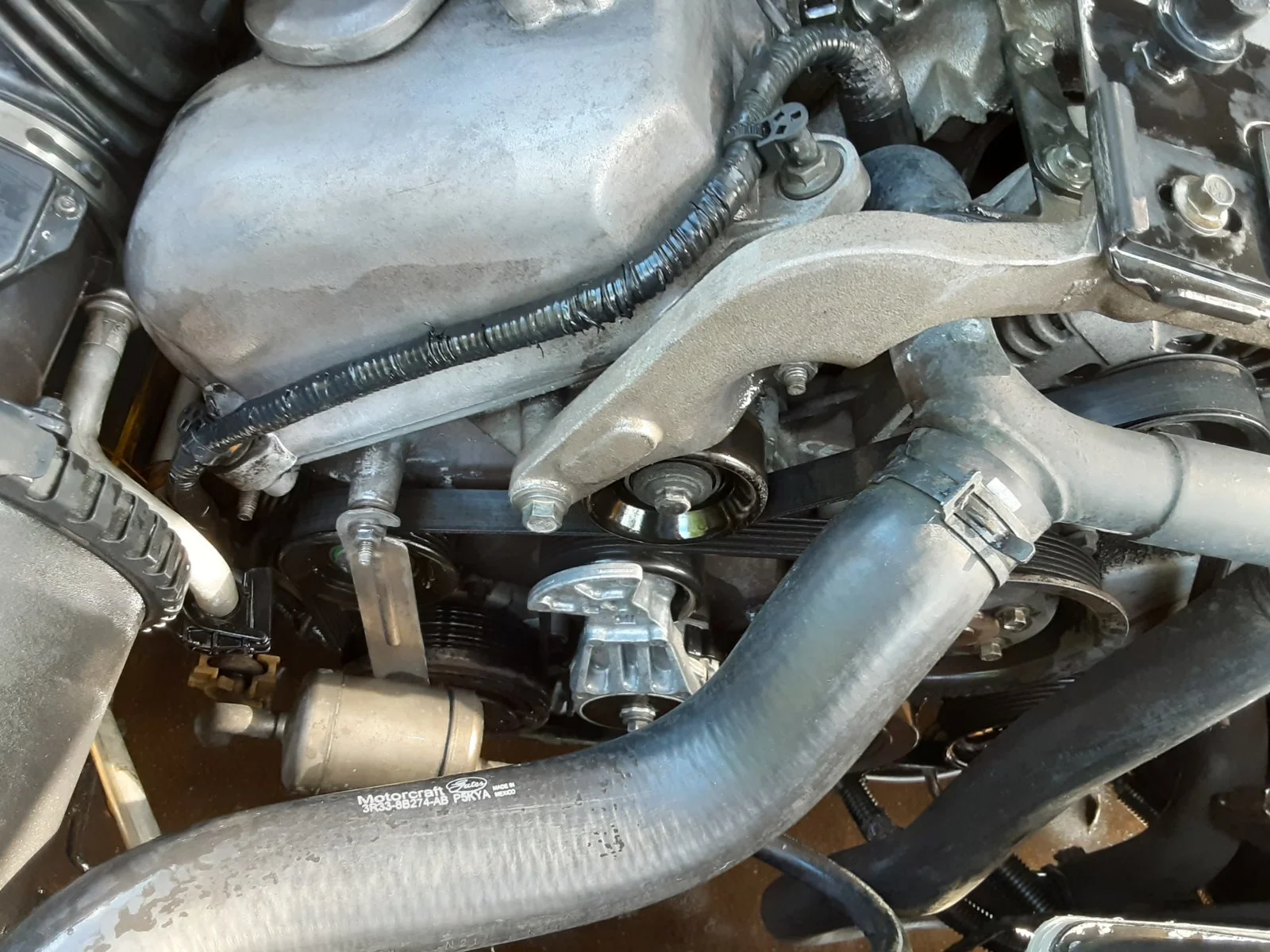

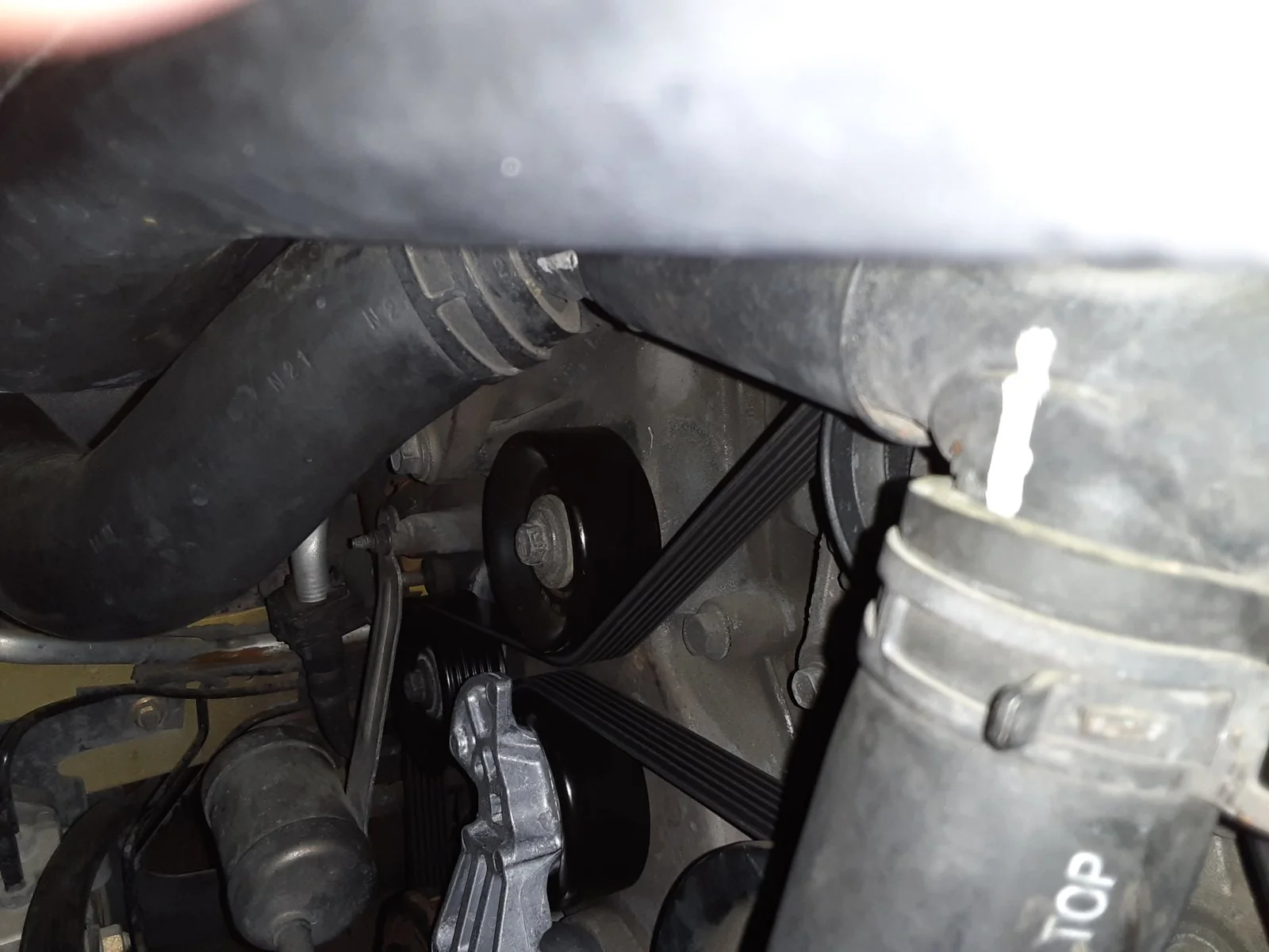

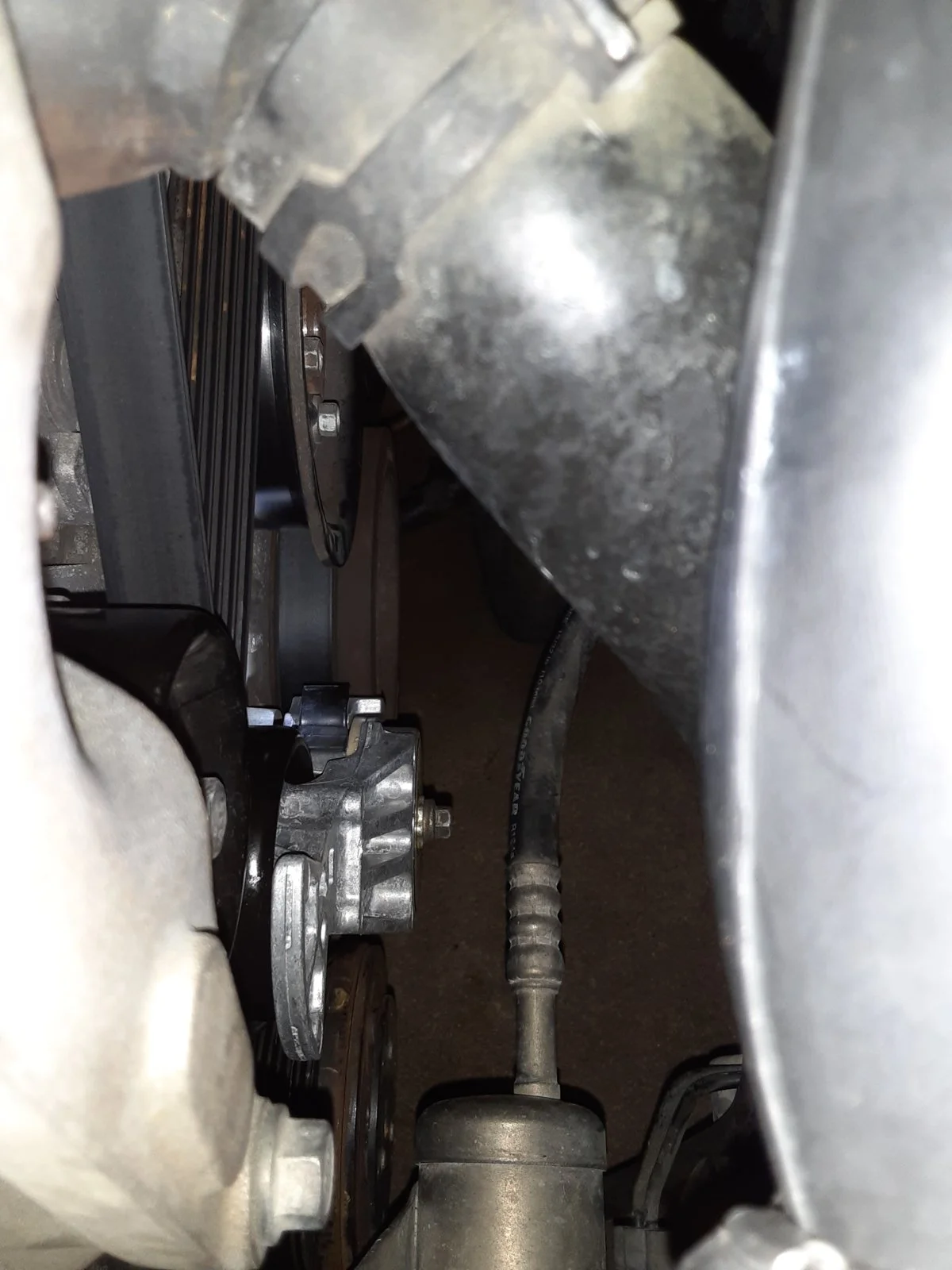

Can you post a picture of the belt routing. I'm especially interested to see the idler pulley near the alternator on the right side of the motor.

This is the best I can do tonight without removing the shaker, can get better pics tomorrow if needed. The pulleys have the rust color on them since it hasnt been driven much last couple days and been raining.
I went ahead and replaced the idlers and tensioner just to be sure and they werent too much.

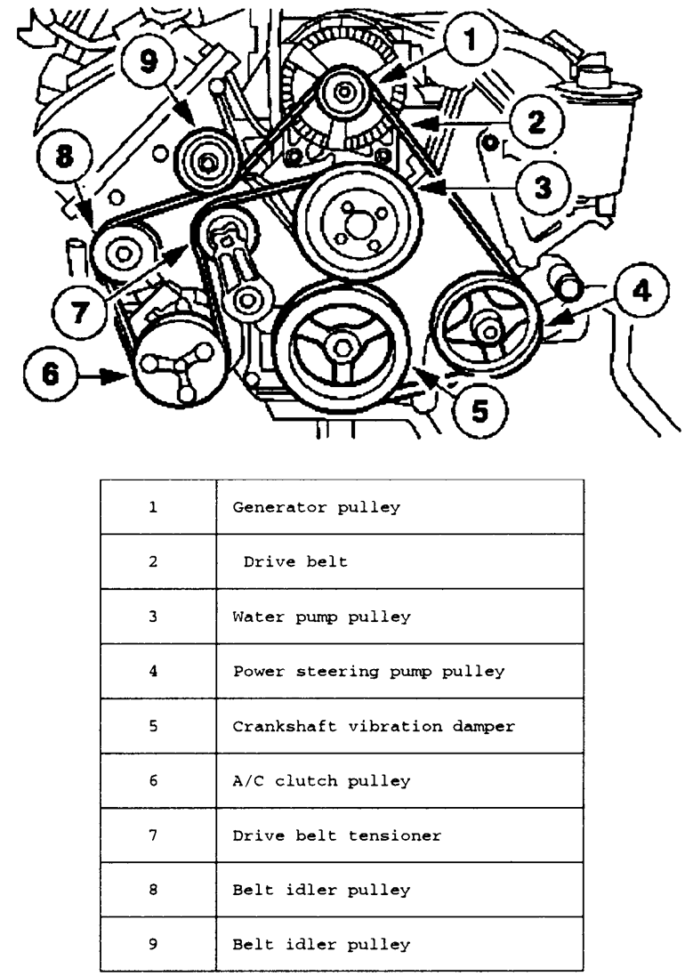

This the routing diagram I keep and follow.
