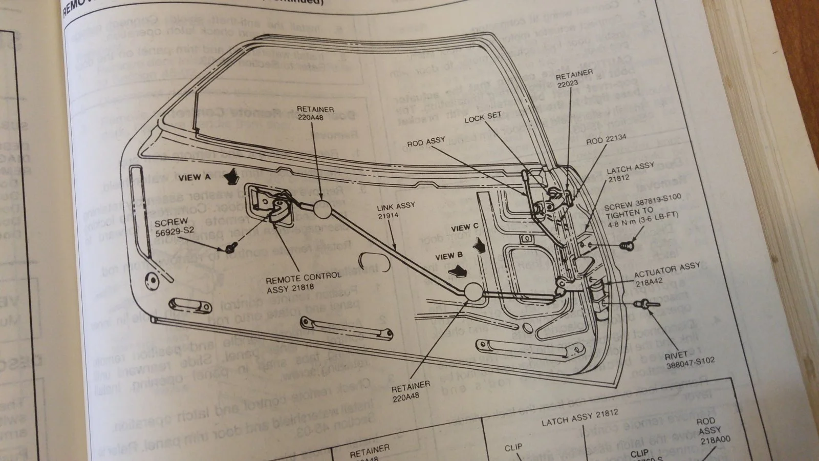

Hey guys. Trying to put my doors back together and can't figure out where all the lock rods connect. Anyone have a good way to describe how to? I have a 93 notch. How many rods am I supposed to have total?

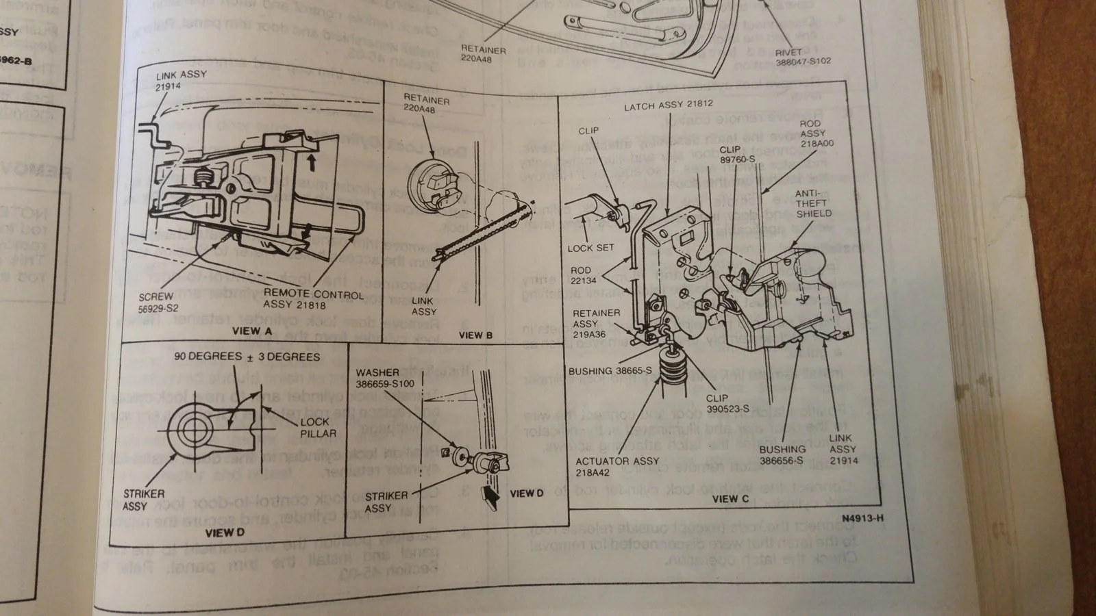

hope this helps with the lock rods, as for the image from a phone thing I load the pics to my pc first, I don't post from my phone.
