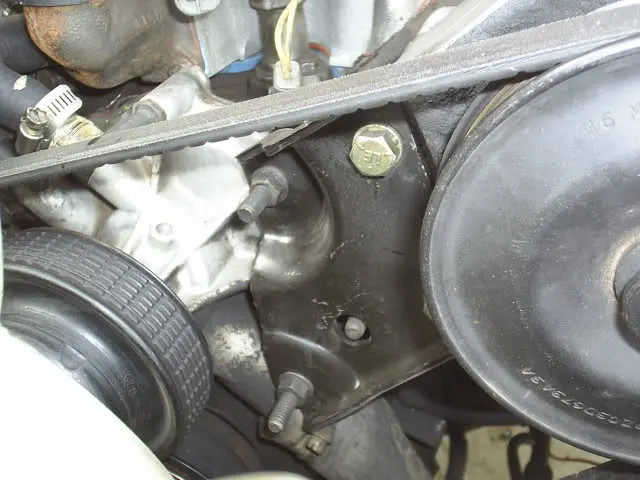

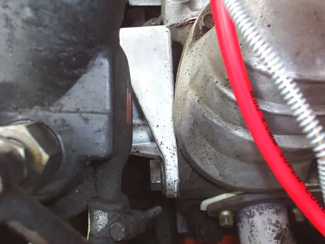

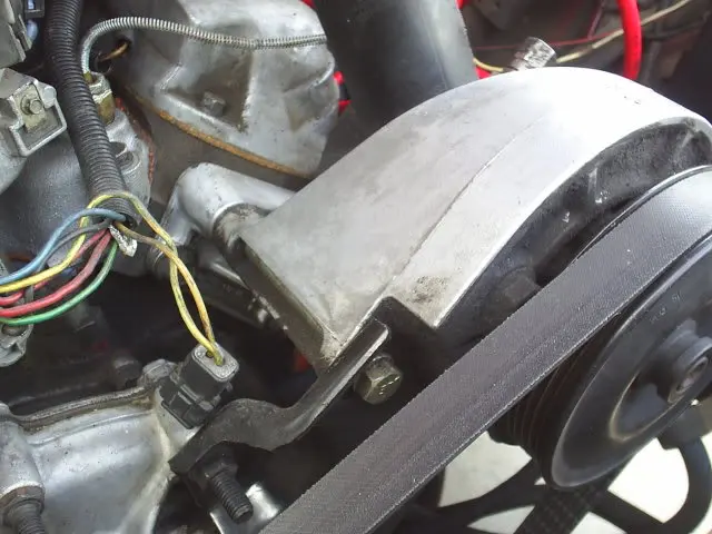

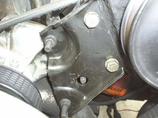

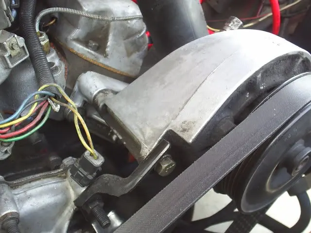

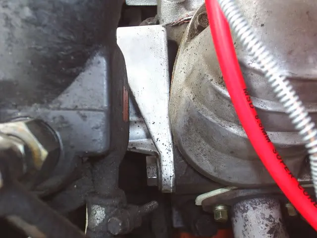

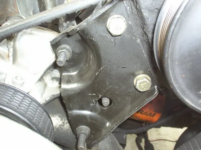

i just took some shots of my a/c delete, p/s swap....the hardest part was getting the thermactor plug off of the head, all the new brackets went on pretty much the same way the old ones came off...
and yes i know, that fram filter needs to go i have seen the light, i was wondering why my oil pressure was low....:rlaugh:

I have the alternator kit from march. Not only did it allow my to chuck the old tensioner but the whole damn ugly alternator bracket. I was pretty happy with it. Only down side is I can't remove the belf as fast as I used to but I don't have to do that so often anyway. I do have underdrive pulleys and the belt size is labeled on the belt. When I get some time from work to look at it I'll let you know the size.
You only have to do modifications if you have the stock bracket still on. The alt is bigger and he needed to be cut a little. Look at the pic of the old bracket closely and you will see right in the middle where I had to chip away. With the march kit there isn't anything surrounding the alt. So no modifications are needed. Just bolt and go!

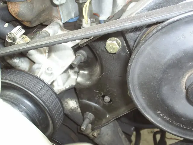

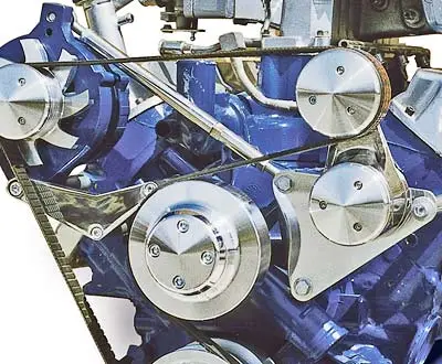

The one you got is the March kit that moves the stock tensioner over to where the A/C compressor used to be. The P/S pump stays in the stock location. Here's a pic of my car a few years ago when I had the March A/C delete kit. It's not the best pic, but if you look close, you'll get the general idea.
attachment.php
Hope this helps! :nice:
