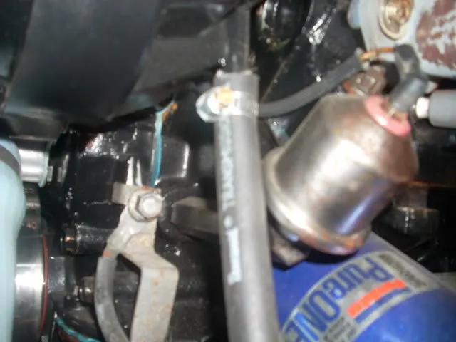

Can't find neg, battery to block attachment point
It shares a bolt with something else...I can't remember what at the moment. But it is in the area you described. It doesn't really matter as long as you get a good ground. Just attach it wherever you can.
Some other thoughts on the ground...
The picture shows the common ground point for the battery & extra 3G
alternator ground wire as described above in paragraph 2. A screwdriver
points to the bolt that is the common ground point.
The battery common ground is a 10 gauge pigtail with the computer ground
attached to it.
Picture courtesy timewarped1972
Correct negative battery ground cable.

The computer has its own dedicated power ground that comes off the ground pigtail
on the battery ground wire. Due to it's proximity to the battery, it may become
corroded by acid fumes from the battery.
In 86-90 model cars, it is a black cylinder about 2 1/2" long by 1" diameter with a black/lt green wire.
In 91-95 model cars it is a black cylinder about 2 1/2" long by 1" diameter with a black/white wire.
You'll find it up next to the starter solenoid where the wire goes into the wiring harness.
