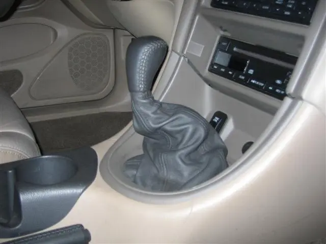

put mine in tonight took three hours, took my time, and had to go back a couple of steps. I'm 5-9, 5-10, and the blue handle isn't a problem at all. not nearly as short as I thought, I have a b&m knob. The gears line up good, and it definately feels more percise. Just went around the block. I guess it was worth it. well see after some more driving. chris
pics

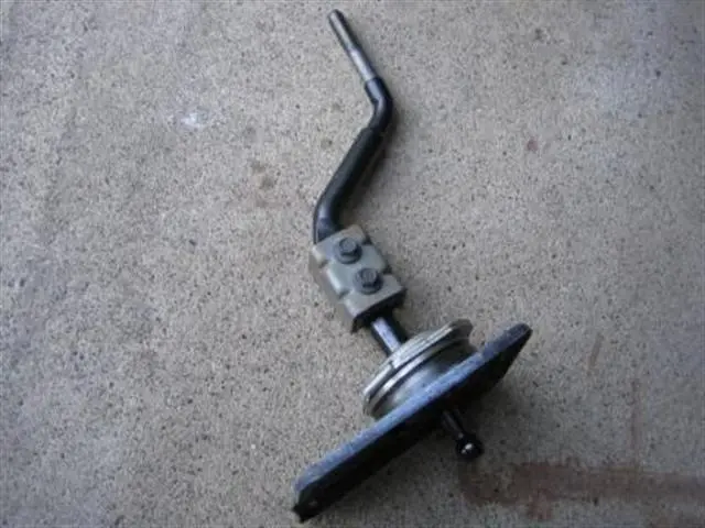

Heres the stocker and the MGW :nice:
Kinda hard to tell from my pic, but the base on the stocker is only like 1/8 of an inch thick :notnice: The side view shows the lip, it curves up an is about 1/3 as thick as it looks in the picture.

The MGW is a better design. I had a Triax in my past Stang and I prefer the MGW, here's why:
-The MGW has a thicker, heavier base that seems to greatly reduce vibration.
-The MGW has is made so that you dont have to cut your inner dust boot which seems to reduce tranny noise over the Triax.
-The MGW handle design seems to grealy reduce vibration and tranny noise.
When I had my Triax, downshifting especially would cause the shifter handle to vibrate badly and loudly. The MGW is slightly less "notchy" than the triax and seems to shift more smoothly while still feeling much more precise than the stocker.
In a nutshell...It's much quieter and has less vibration when compared to other shifers. After a few days of getting used to it, I cant imagine going back to stock!
