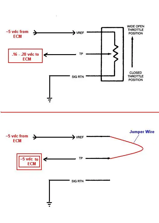

Check the graphical description of the situation, analyze it and LMK what do you see different.
Diagram 1 is correct with the exception that VREF +/- 5v and TP sig +/- .17v occurs both with SIGRTN connected and cut.
In looking at the diagram, it makes no sense, but if you note all of my last voltage readings were with SIGRTN cut.
Diagram 2 is 100% correct.
Looks like a bad TPS sensor to me, but if that is true, how the heck did I get 3 bad sensors in a row form different sources that give the same reading???????
Doesn't make sense to me...........
i see up put .5v /pin 26 and jumped to 47,,and that gives .5v than when you move throttle volts will chang by .5v if tps is good...,,in side of tps 46 is removed and dvom is used as pin 47 would in the first place;;;just for ****s and giggles can he hook up a tps at the pcm and bypass all circuits than tps should read right?
It does make sense, if you use the variable resistor the TPS is, and check voltage between VREF and TP, you read the out of range values you've posted, with the SIGRTN wire removed from the TPS....... the resistor portion is removed from the TPS, TP wire reading should be = to VREF input, which is exactly the same condition as replacing the variable resistor with a jumper. Since TP = VREF when the TPS is replaced with a jumper wire..... therefore........ what is the logical component with the fault.
BTW.... for S&G's, I just confirmed the results above using a KGU TPS in a Ford I have in the shop for a valve train upgrade.
Anyway, measure the resistance at the TPS VREF and TP wires.... it should start ~3.3kΩ closed throttle and drop to ~.26kΩ (260Ω) @WOT. LUK

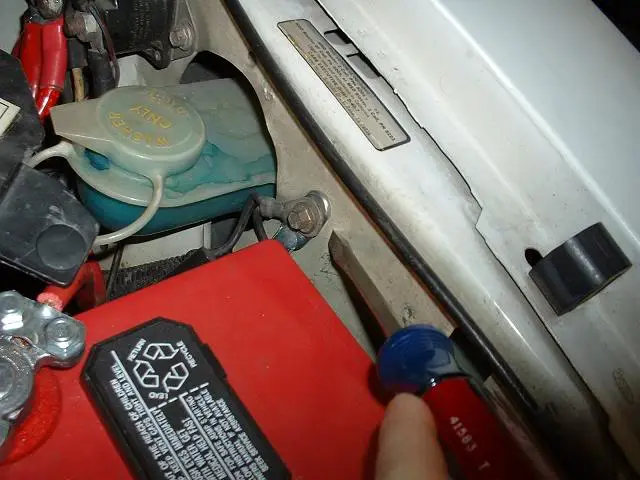

- neg batt to engine
- neg batt to front radiator support
- neg batt to engine harness ground point by solenoid
- engine harness ground point by solenoid to engine block
- engine block to frame
- engine block to firewall
- injector harness ground goes to firewall not rear cyl head
- eec ground point underneath EEC in cabin
I am missing any ground points??
Thoughts??

Looks like a ground problem??
FWIW- I have cleaned and tightened all the ground wires that I am aware of
Thoughts??
