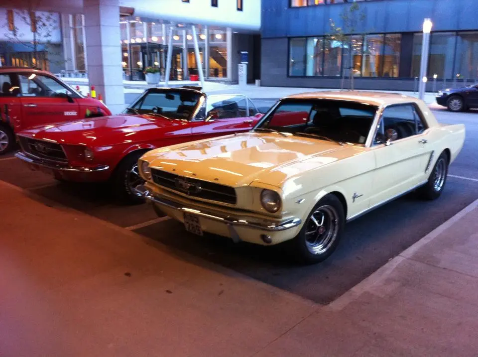

Well, I can at lest post a pic of the car (yellow one)
