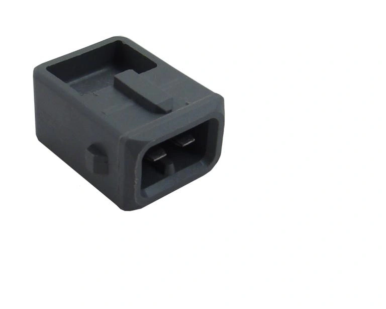

Remove the SPOUT jumper
SPOUT Connector
spout-connector-jpg.668761
It is the 2 pin rectangular plug on the distributor wiring harness. Only the EFI Mustang engines have a SPOUT. If yours is not EFI, check for a SPOUT: if you don’t find one, skip any instructions regarding the SPOUT. The SPOUT (Spark Out) enables the computer to control the spark advance. When the SPOUT is removed, the ignition timing reverts to the base ignition timing set by either the spark rod inside the distributor or the physical position of the distributor.
Warning: there are only two places the SPOUT should be when you time the engine. The first place is in your pocket while you are setting the timing and the second is back in the harness when you finish. The little bugger is too easy to lose and too hard to find a replacement.
