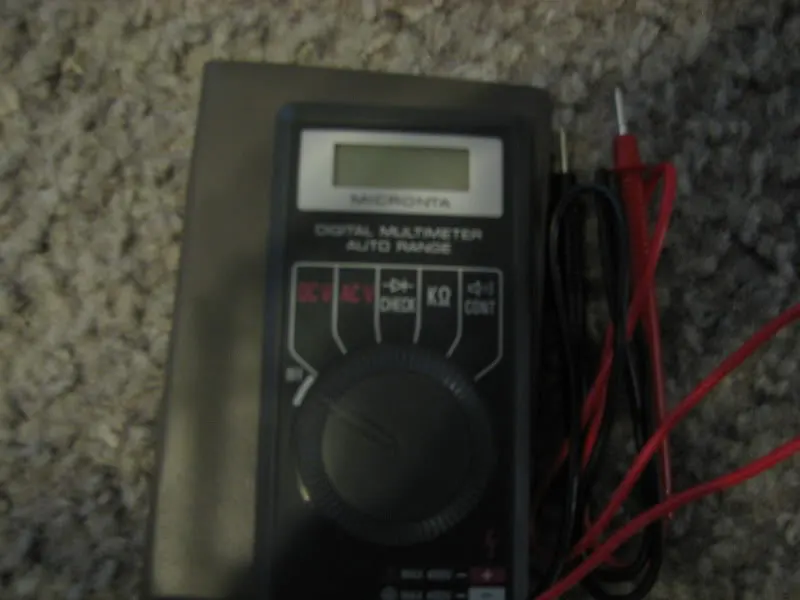

good news, i found out that i have a multimeter...its 20 years old but had never been used... will that work? it looks like this

thanks for the quick multimeter schooling wm

ok did the test...the battery was reading 10.5-10.8 consistantly... had my girlfriend start(well try to start) the car as i was holding the probes... right as she turned the key the voltage dropped to 9.something then straight to 5.25 and hovered in the 5's
im guessing i need to have my battery charged :shrug:
