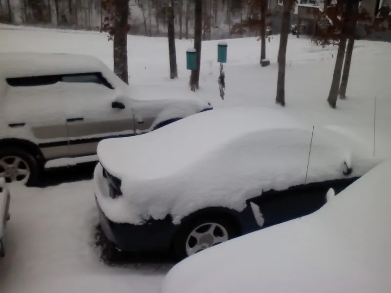

deh...the weather kinda went to shat overnight so it looks like i wont be touching the car at least for today...supposed to start snowing again on monday so if tomorrw it clear i guess ill be shoveling the snow away from my car.... ill keep you all posted when i get tot try something...heres a little pic just for fun

Posted via Mobile Device no hurt feelings here..ecspecially since you all are trying to help...and unfortunatly yes, i was going clockwise meaning something bad probably has happened...should i try to get it as tight as possible? oh and it wasnt easily turned..i had to put a ton of muscle into it..but i did notice that it was just the bolt moving..no crank movement...
