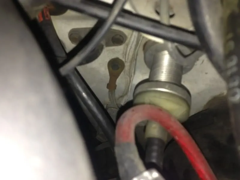

here is a pic of my firewall adjuster... thing

The way it's behaving, the cable needs to be adjusted shorter. I can't see :poo: from your picture but if you really have a firewall adjuster, dial it out, away from the firewall several full turns. If you do need a cable, don't get an adjustable one, they all suck. Do the adjusting at the firewall.

Ok, better pic, pretty sure it's some kind of aftermarket adjuster. I couldn't get in there good enough to see if the quadrant was aftermarket but I'm starting to wonder.
Tomorrow I'll pull the cover on the tranny and see if its a aftermarket adjustable cable. Tonight I could smell the clutch so I know it's not adjusted right. The fact that adjuster is so far out makes me think either the cable is stretched or its an adjustable cable and the cable needs adjusted at the tranny.
That looks like it's extended out a lot, shortening the cable more than it should have to be, unless it's an adjustable cable that was never adjusted tight enough in the first place. But the fact that the clutch drags when depressed, like the cable is adjusted too loose and never fully releases the clutch, is in conflict with the fact that you can smell it. That suggests the cable is adjusted too tight, and is never letting the clutch fully engage, so it's slipping. Maybe the cable is fubar'd down at the transmission end.
