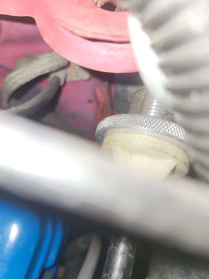

I watched the LMR video on adjustable cables and noticed that the firewall adjuster was screwed nearly all the way in. Mine is out about 7/8". A friend mentioned that the cable may be stretched and at the end of its adjustment (which is what sent me down this rabbit hole).

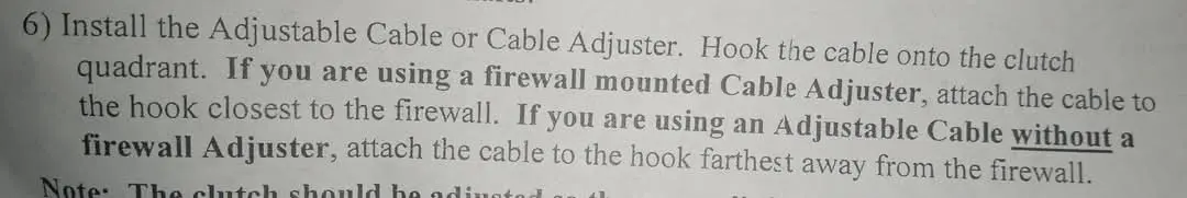

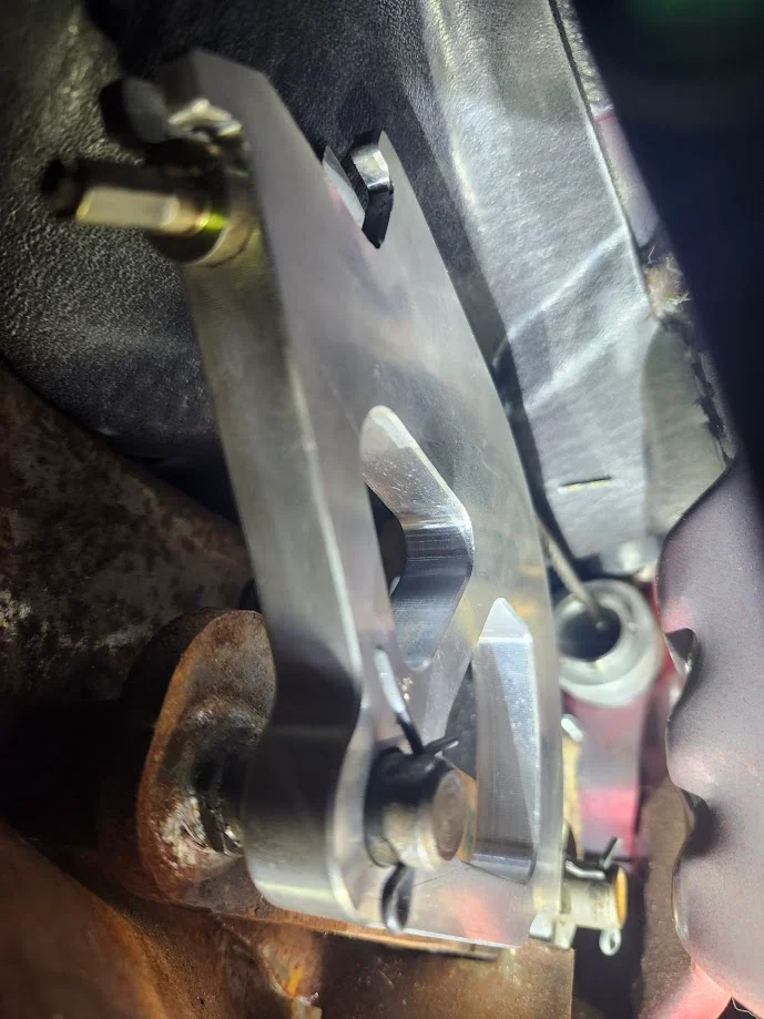

Then, someone on Facebook shared this:
So, I looked around and, sure enough, the cable is attached to the farthest hook.
That leads me to my question(s). What would you do?
- Fix the quadrant cable placement, screw the firewall adapter all the way in, and start over with the adjustment down at the clutch arm end.
- Leave the quadrant alone, but start over with a basic clutch adjustment.
Another option: Don't do anything until the new shifter and bushing are installed!
I am using an adjustable cable with a firewall adjuster and have it hooked on the one furthest from the fire wall on both cars.

So... you're saying don't worry too much about the cable placement on the quadrant? How far out is your firewall adjuster? Is nearly and inch out too much?

My adjuster is mid way in the threads so about 1/2". I adjusted the cable to get the pedal where I wanted it. This allows me to adjust either way with the firewall adjuster and not have to get back under the car.
Unless the shop you are going to knows what they are doing I would not let them touch anything to do with a clutch. You should be able to pop the cover off the clutch fork and tell if it is an adjustable or stock style without glasses. If it is a stock style then I would say its stretched and you need to replace it. If its an adjustable and there are more threads then you can solve the problem by screwing the adjuster in and taking up the slack with the cable.
The odd thing about using the firewall adjuster is that you will need to screw it into the firewall as the clutch wears. @nickyb is on the money with MM's instructions so here they are:
