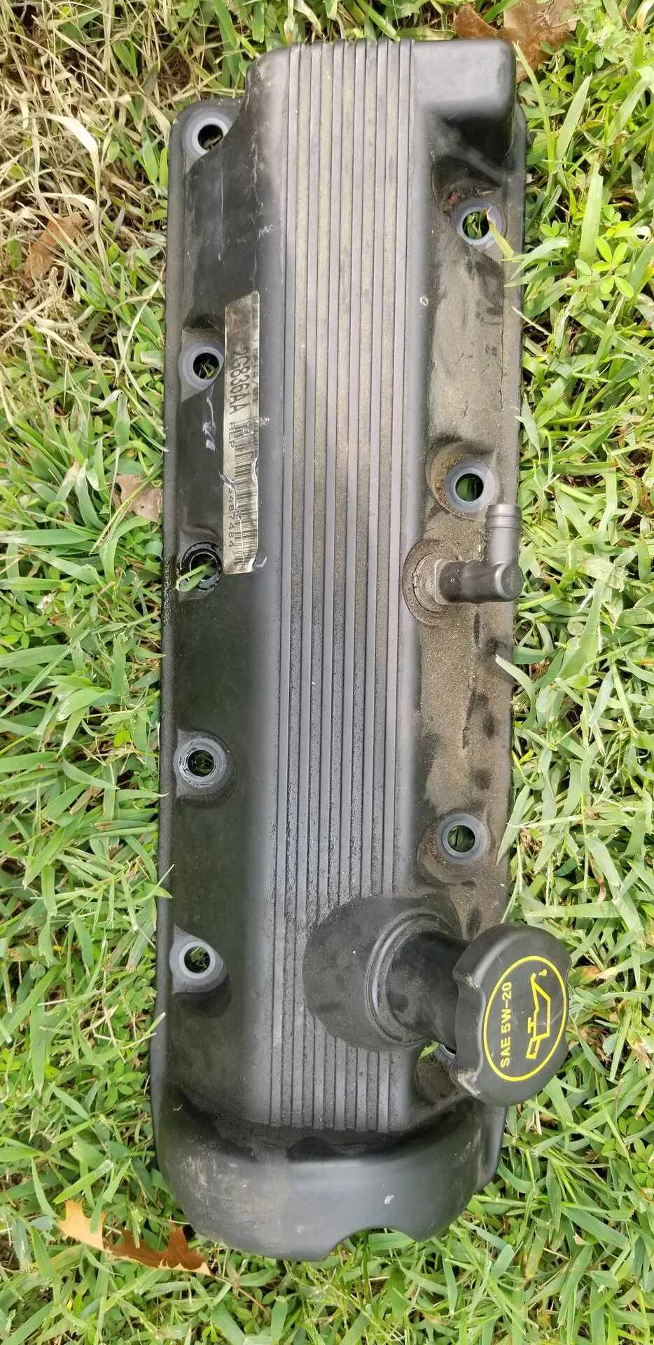

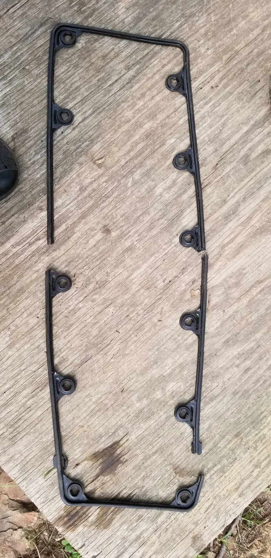

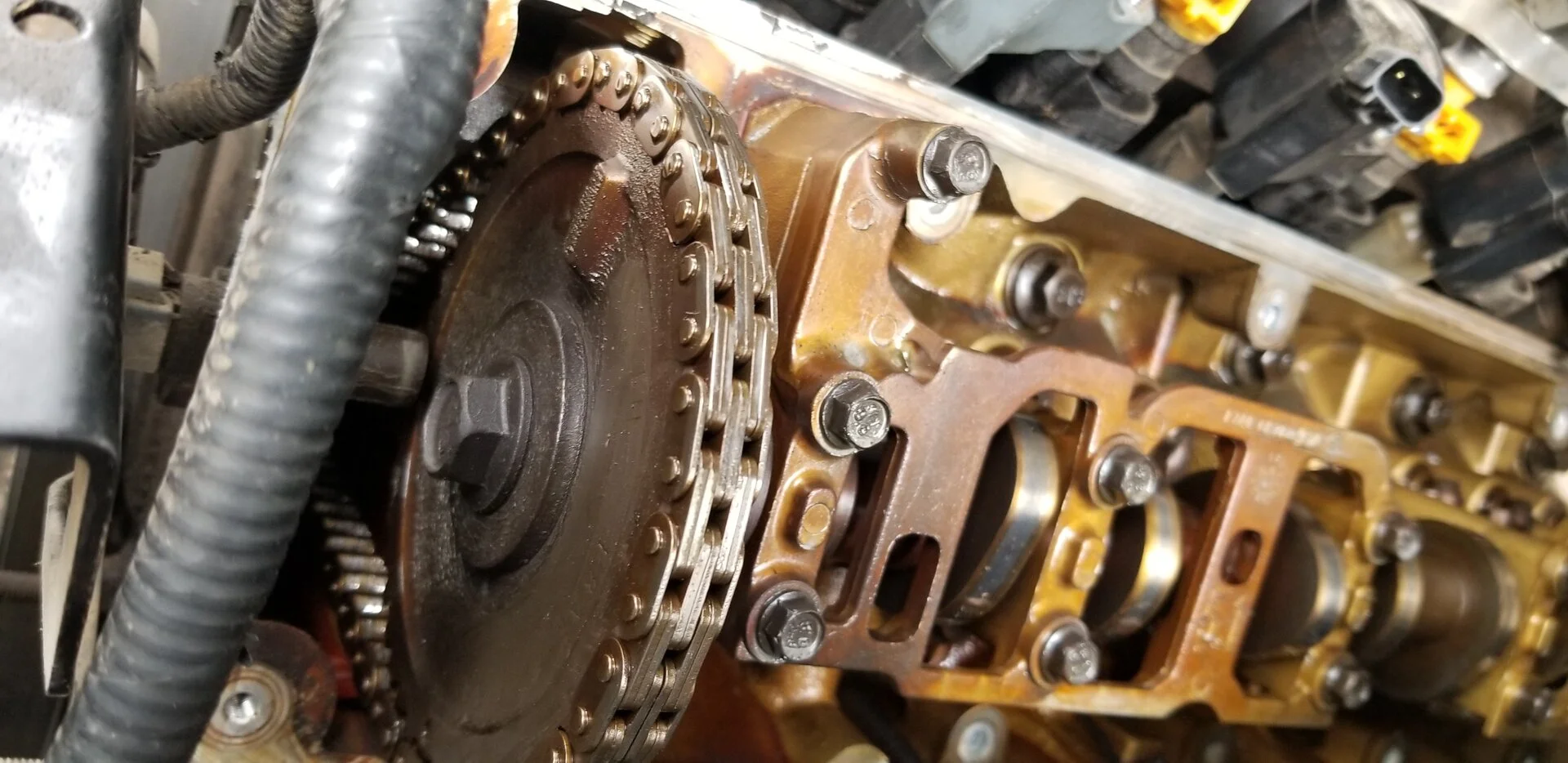

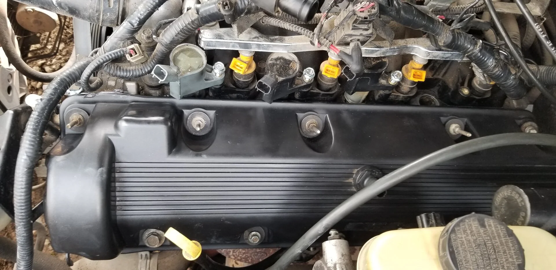

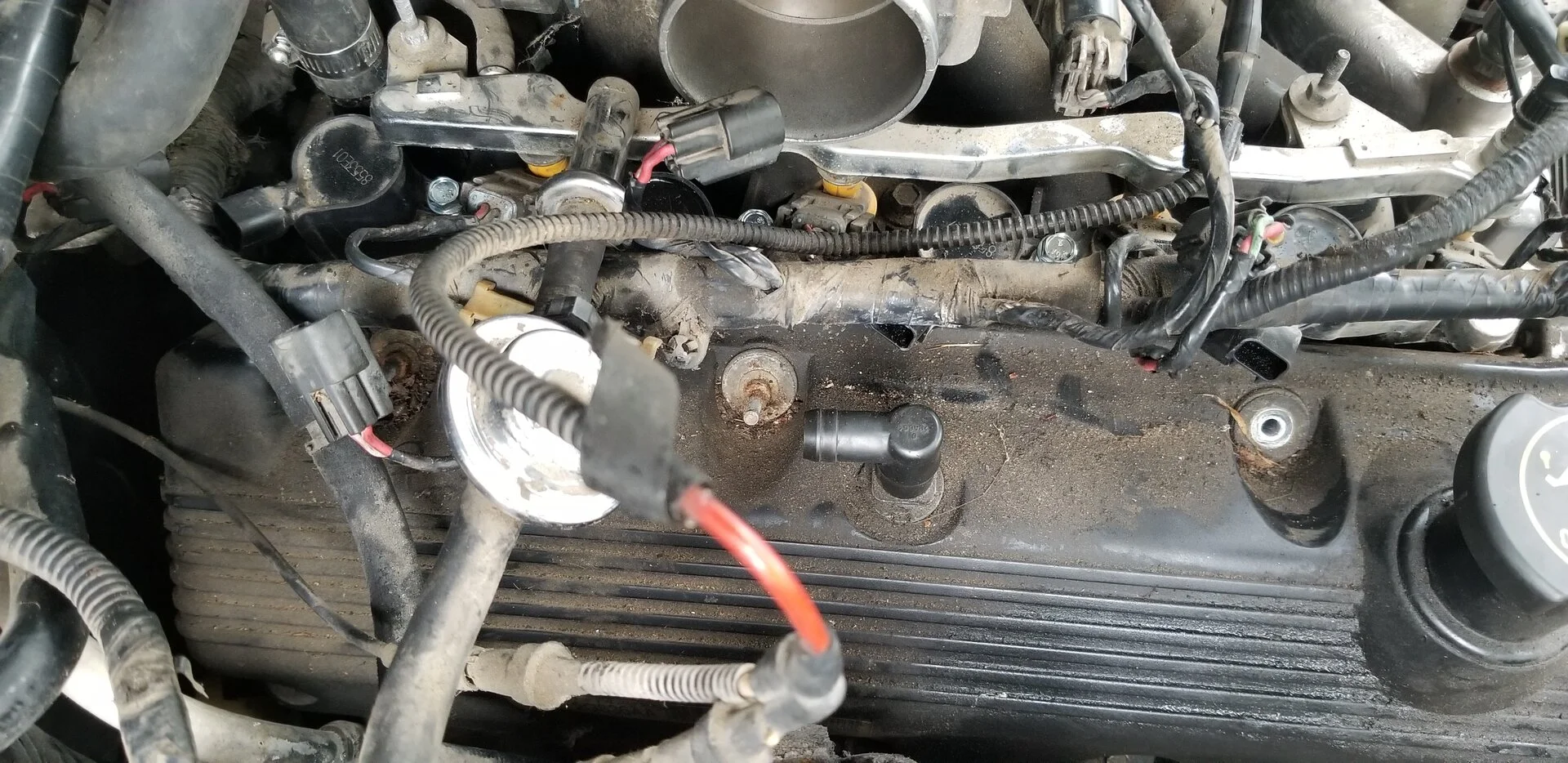

Ok got driver side valve cover off and out of car, what a pain in the butt! The gasket broke apart in my hands so pretty sure it was bad lol, now that I have it off anyone got some suggestions for what to visually inspect while it's off? This is past my general knowledge area, I know the workings but I couldn't tell by looking if something was wrong lol. Going to clean them up real good put a new gasket on with some rtv and drink some beer. Thanks for reading!
Some pictures, I was able to get both off by just moving the wiring harness, didn't mess with either the MC or fuel rail.

180k...do you know if the timing chains/rubs have been replaced and at what point?
As far as I know they have not... Could that be the ticking sound I hear now from the driver side valve cover? At first I thought it might just be a stuck or sluggish valve but now you got me wondering if it's something else... Lol is that a difficult job? Does it involve pulling the motor? Here is a short video of the noise, only when I give it throttle otherwise hardly any noise except normal drive train taps.
Edit
Nevermind I'll have to host the video somewhere else it's too big
Those videos were taken prior to replacing the valve cover gaskets, I don't have post ones yet but the hard tapping isn't as bad after the replacement but still noticeable I'll get another video when I can get a chance.
Take a long screwdriver (or a mechanic's stethoscope) place it against your ear, and hold it against the valve covers (up and down the length), alternator, ps pump, idler pulley mount, water pump...etc. You'll hear the tap distinctly when you you are on or near it. Your first video sounds like belt noise and a rough idle room pulley to me...try pulling the belt off to check for roughness in the pulley.
Replacing the timing chains and followers can be a chore, but is within the realm of a diy'r. I recommend you look at some of the write ups and videos about it.
I did as you suggested, first you were correct the pulley on the idler arm was gritty feeling when I spin it so adding that to the shopping list. I used a 12 inch 3/4 drive extention (longest piece of solid metal I could find) and listened all over. The tap is definitely coming from under driver side valve cover and it seems to be about mid way down it where it's the loudest. I was given the suggestion it could be lash adjuster which im about to research because I don't even know what that is lol I'm hopeful it's not the crankshaft and I don't have a main bearing going out, pretty sure it's somewhere in the driver side head.

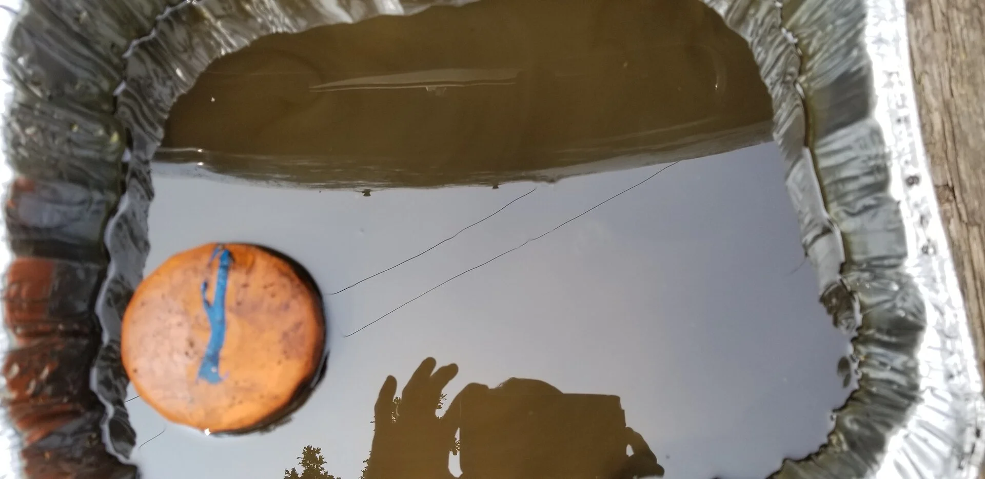

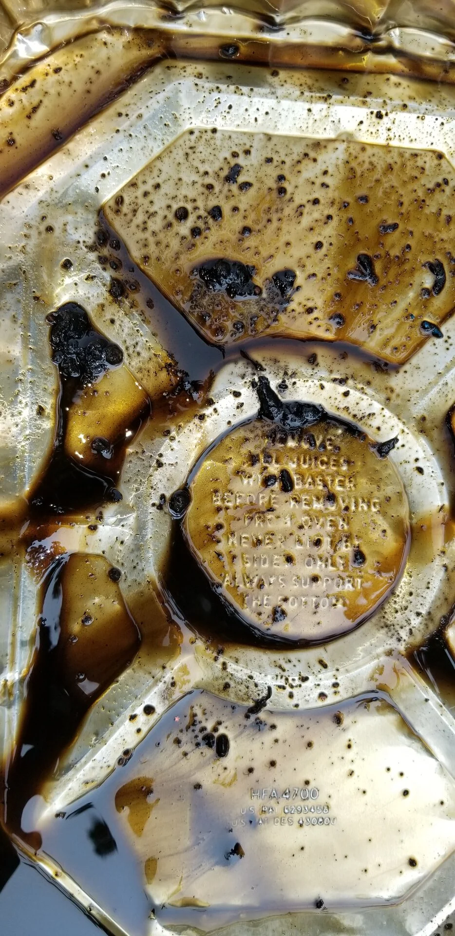

Ok so update time! Here are some pics of the oil after replacing the old oil that sat for almost 3 years with fresh oil and adding motor medic engine flush. I stupidly didn't read closely the directions and instead of just letting it idle for 5 minutes I let it run about 10 and did drive it about 1/4 mile total just to turn the car around. Anyway first pic is what the oil looked like and 2nd pic will be what was at the bottom of a clean pan. Refilled with 5 quarts of STP 5/20 and a new STP filter, going to run that till next weekend then do another oil change then put in some Mobil 1 with a better filter. Thoughts on any of this appreciated or if you just want to say hi!
