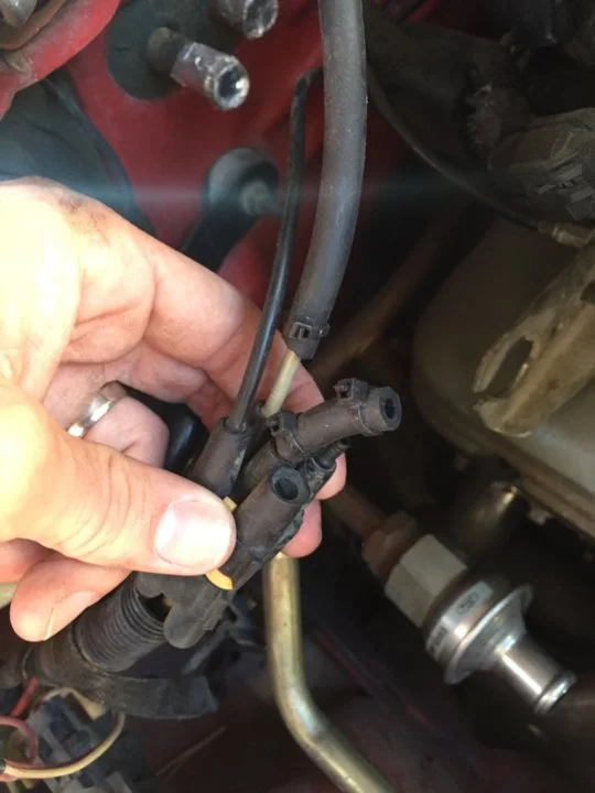

Man seems like every time I do something on this car something else happens. It was indeed an exhaust leak and a new gasket fixed it but this emissions stuff is as fragile as glass. 2 of the plastic tubes shattered as soon as I touched them and am at a loss now. Can it be bypasses if there are no emissions standards or would it be better to replace what was broken/missing. Have a look.

THose hard lines always break. You have 2 options
Napa, autozone sell replacement hard plastic lines
Use some small diameter brake line
or,....
just use rubber vacuum hoses

I can't seem to find a diagram of what goes where. Do you have a link to guide me in the right direction perhaps? One came out and am at a loss as to where it goes. Half of my smog stuff isn't even hooked up I.e smog pump and the rubber hose that leads to it is just hanging out

Or if someone could snap a pic of theirs that would be greatly appreciated

Jrichker that is pretty complicated for my blood. The picture I posted is the junction called what? I need a lead off point. As you can tell I am a novice and done see an outlet with 5 runners so a bit confused
