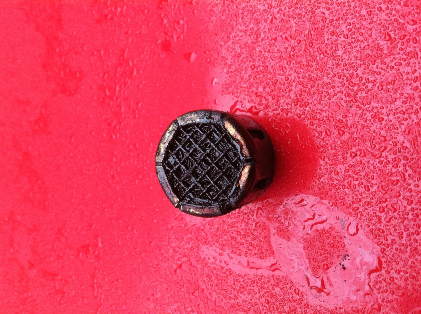

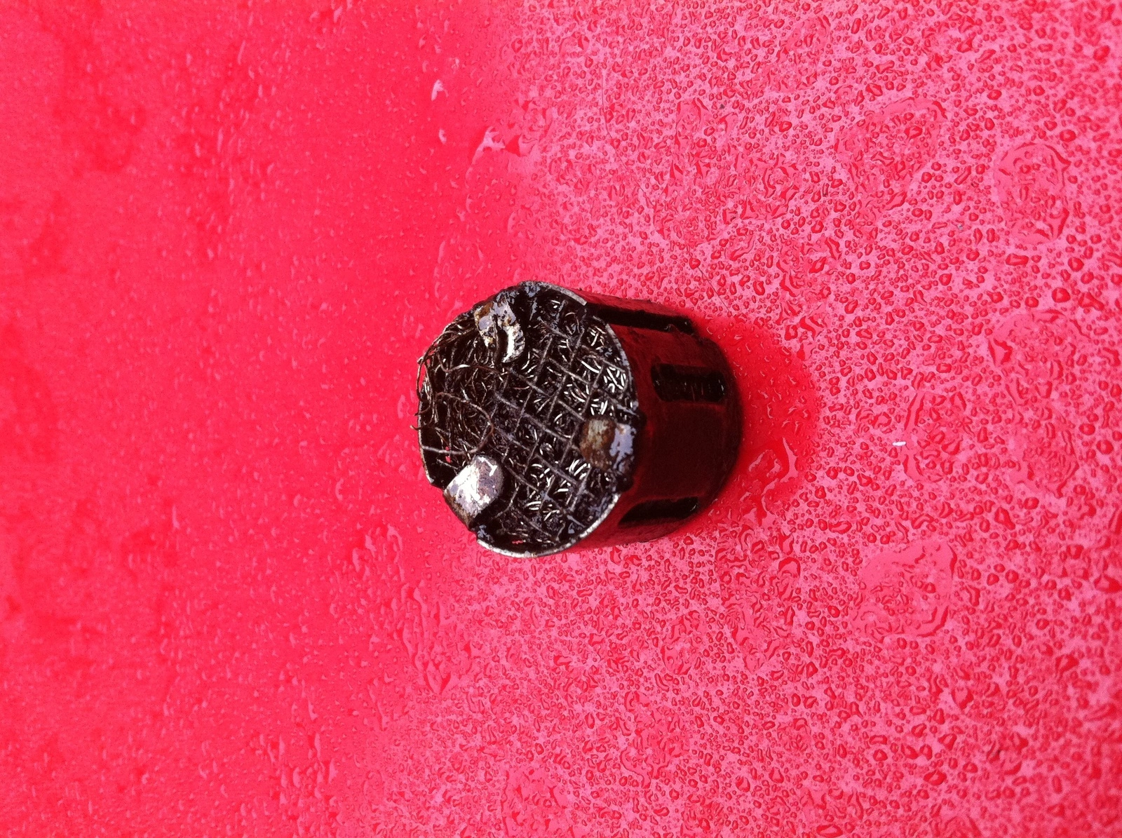

These cars are prone to blow by if you don't keep the PCV system in good order. Replace the old one, make sure the screen is in the bottom of the hole in the intake, make sure all the hoses are not cracked. Make sure the breather tube from the TB to the VC is on. Check all of the vacuum hoses.

Ok guys drove the car to work today decided the see how much an long it smokes for so i turned onto a main state rt and hammered on it throught 3rd and it only smoked when first hammering down and then went away befre i hit second. I got the new breather filter and pcv today but have not have time to install yet but i was glad smoke went away in 1st oh btw this damn car will move

Well got it changed think it might have been the issue

Damn, that looks original factory

I am so glad i asked you guys, i would have most likley pulled motor and put new rings and valve seals in. The othet site im part of had no advice at all I wrenched on cars for the last 6 yrs in a small car lot an have never seen or hears of one of these little guys but now i know and will help other out with 5.0s tell them just to change it out if they didnt know it was there. Thanks again

If the screen gets clogged up quickly, do leak down and compression tests before tearing anything more apart. I have sold the big umbrella stop smoking valve spring/stem kits. But these parts need some oil for lubrication and cooling. The only time I would use one is if it gets so bad that you are fogging the county for mosquitoes.
