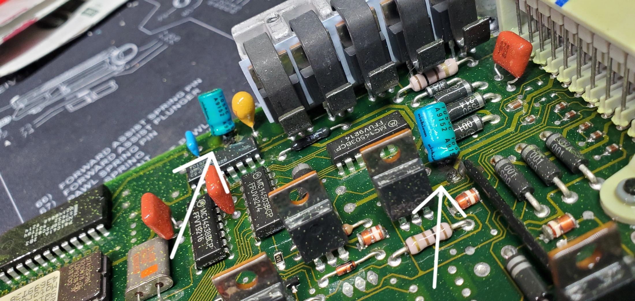

Just posted this pic in another thread also.
This is my ECU I swapped. I was running super rich, very similar to what you described. Got a good ECU from a guy and :burnout:.
