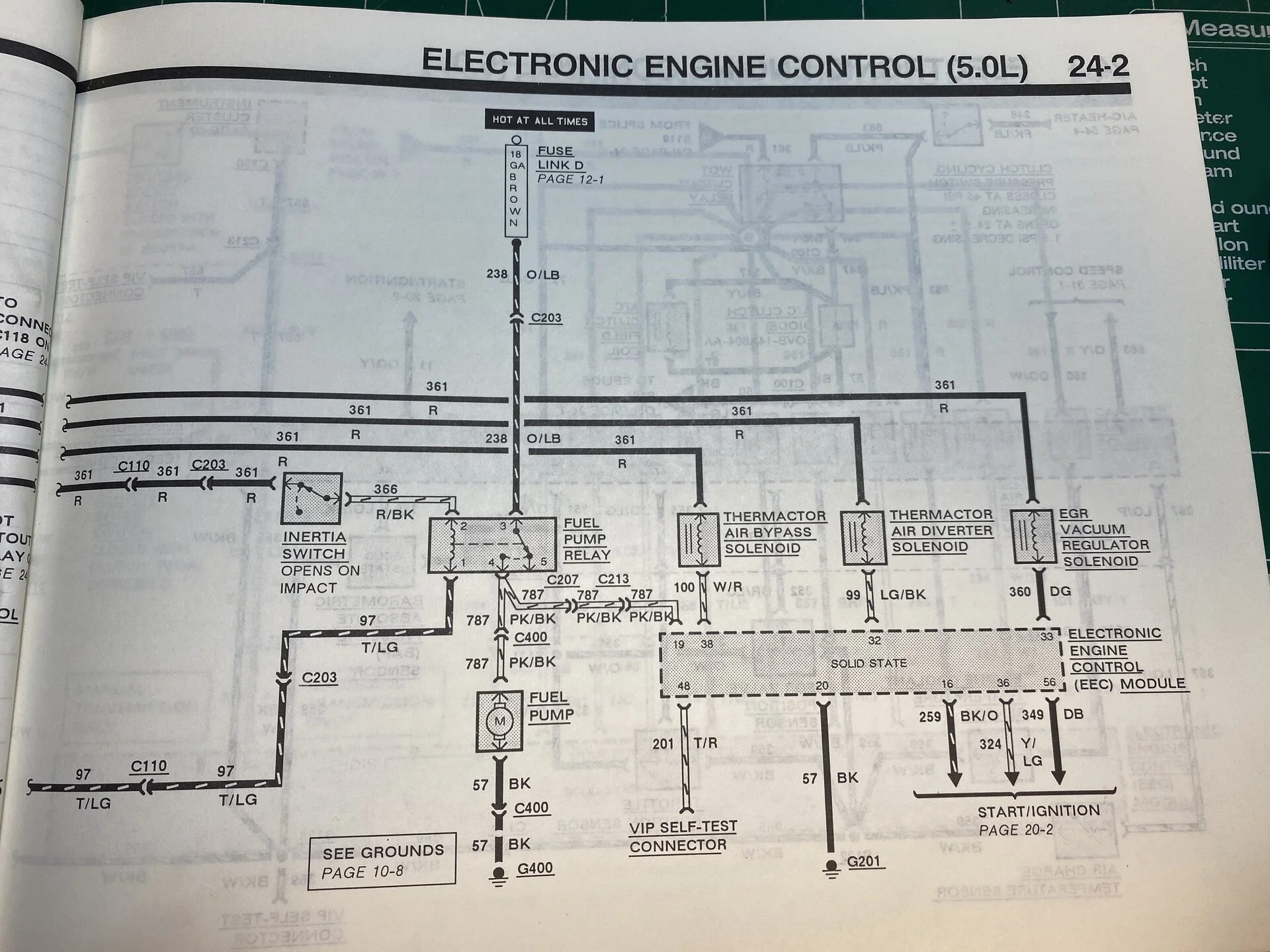

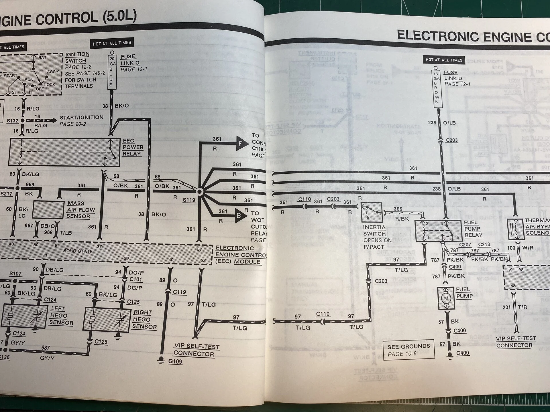

So the way the fuel pump relay works is that the ECU controls the negative side of the relay. It completes the ground to activate the relay. The positive side of the relay is fed by the ECU relay which also feeds other relays on the car.

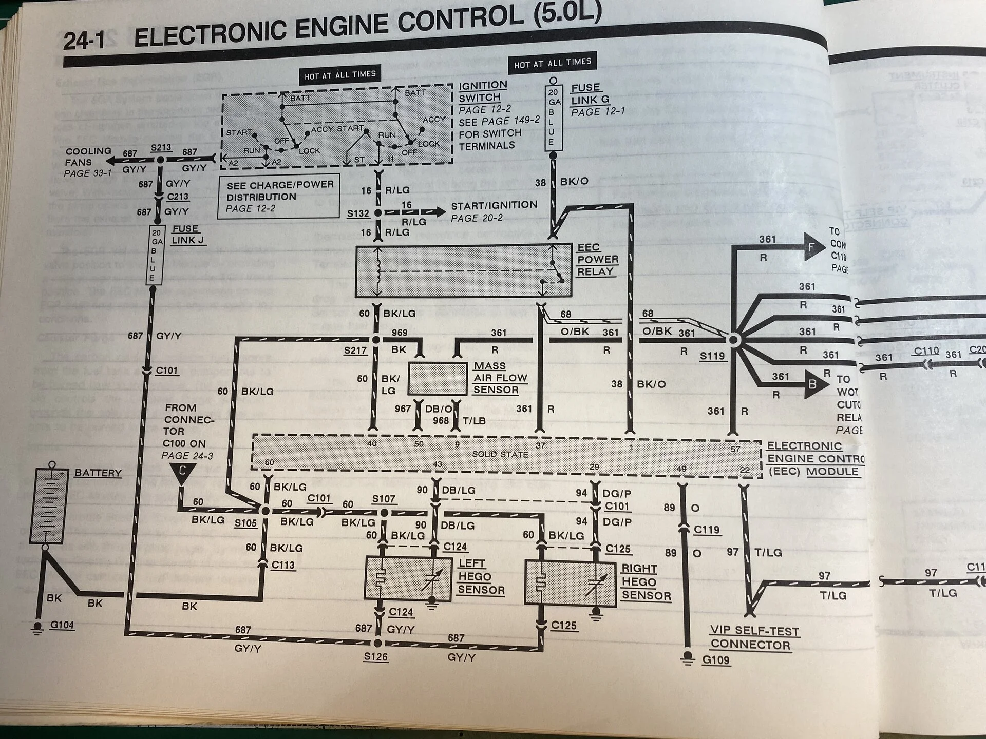

I bet your issue is the EEC power relay mounted next to the ECU.
Zoomed in on the fuel pump circuit.
As you can see, the eec relay feeds the fuel pump relay as well as other solenoids.
What that said, why the eec relay is dropping out is a different story, but first see if you can confirm that the relay is the issue. You should have constant power on the black/orange at all times, and key on power on the orange/black and red wire coming out.
It could be a bad relay, a bad connection or even a bad ignition switch.
