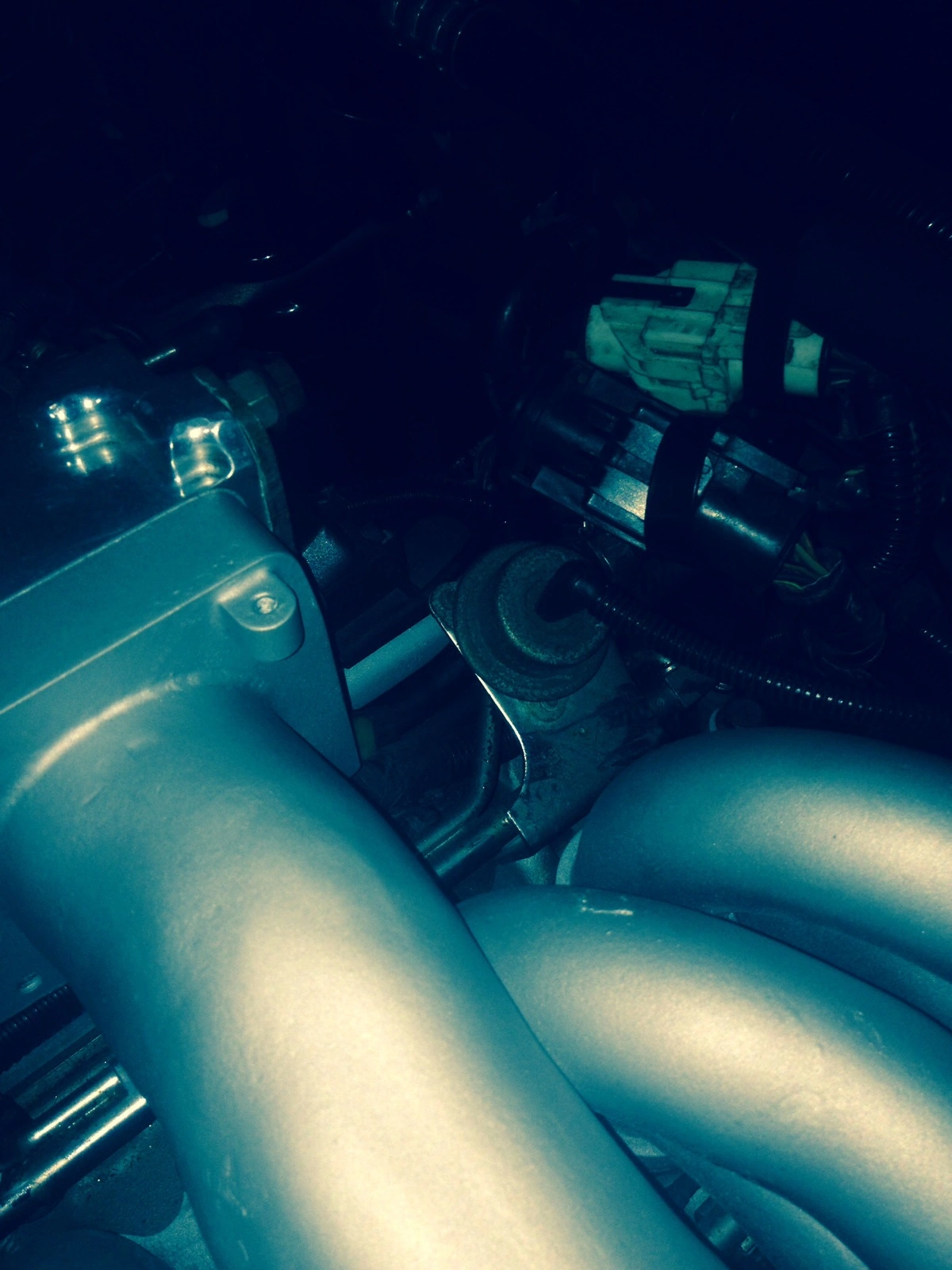

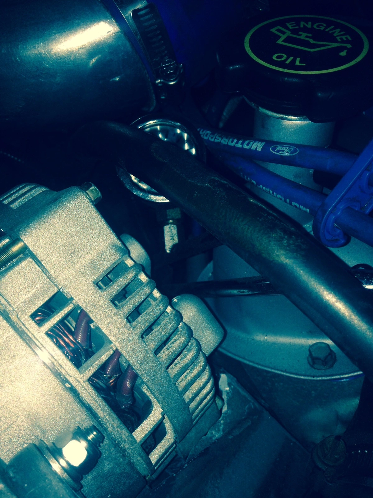

Okay looked your motor year same as mine lol almost.. May be fuel presure here's where my fuel presure gauge is right be hind alternator .in this pic I have aftermarket gauge
If fuel presure is low then check fuel filter first and fuel presure regulator , you can try pulling the vacum line off fuel presure regulator and will increase presur a bit see if that helps but put a nail or something in the vacume line while it's off so there no vacume leak in the intake
Well it's on the left passenger side behind throttle body , but pull off vacum line check for visible gas is one way the other ways not sure but first see if there's fuel presure I guess but stock regulators are cheap and do fail but I don't know how severe the symptoms are just throwing it out there
