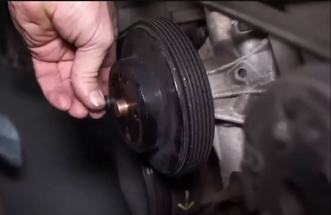

This should give you a pretty good idea. You will need a pulley tho, since yours came with or has E-fans already? :shrug:
Here is an image of the pump pulley. The fan clutch bolts right to it:
Yours may differ because e-fan? You need this ^^^^^ :D

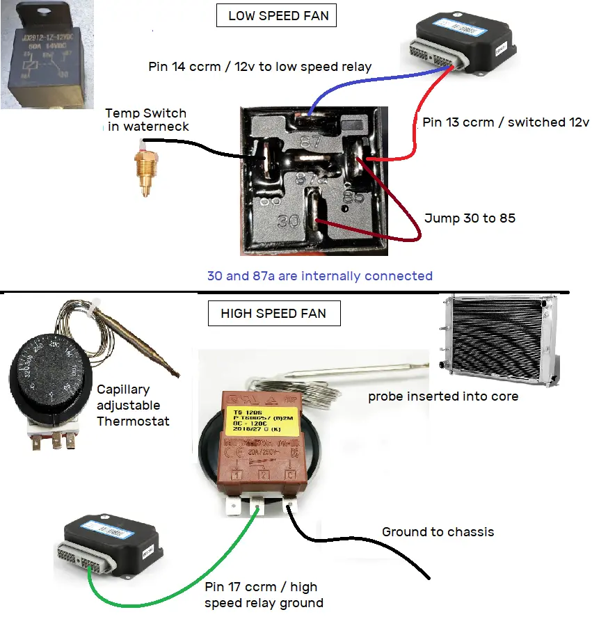

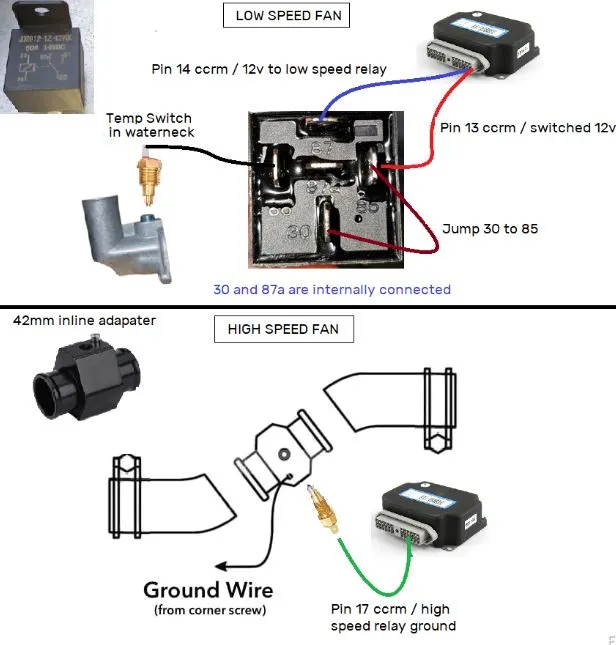

Solved my cooling fan issue
Since I kept the ccrm, I installed a single relay for the Low speed with a thermal switch (200/185) in the water neck. And separately installed an adjustable thermostat switch for the High speed
Some might find it wonky, but all I can say is, it works. Already had the relay, so less than $40 spent
