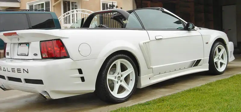

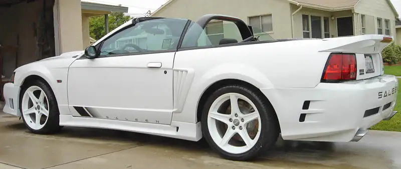

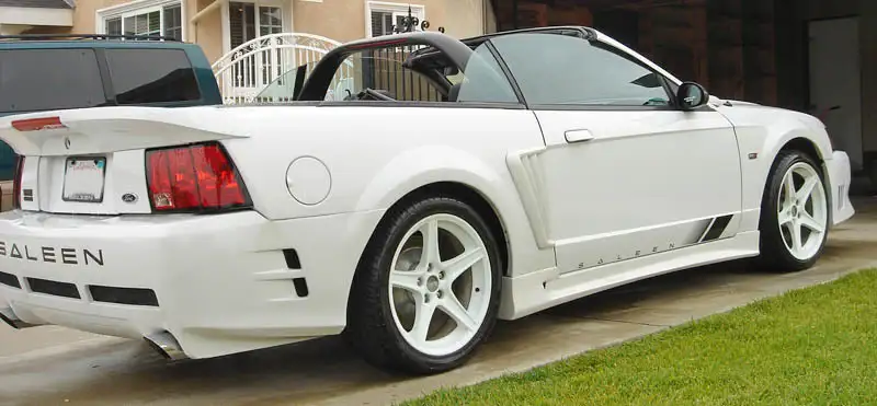

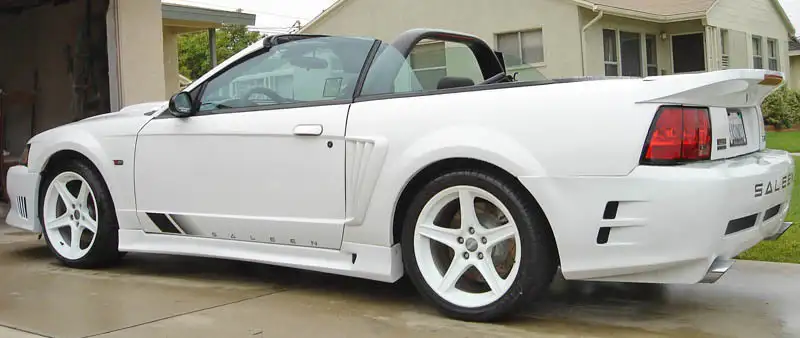

BTW- does any one have pictures of their stang with Eibach pro-kit springs? Whats the drop for a 99-04 stang? I hear the H&R SS springs are close to 2", and I don't think I want it that low.
