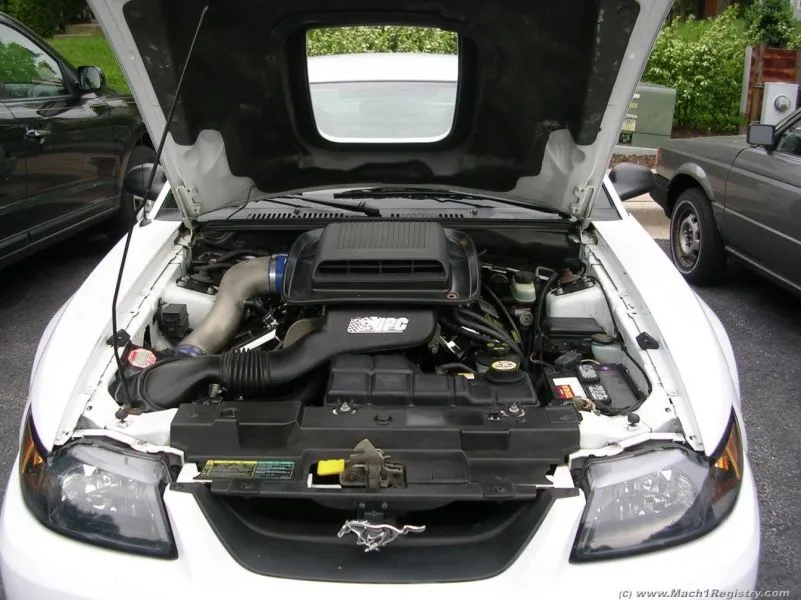

Motor is being worked on now...low oil cause spun rod bearing, f'd up the crank...that was the diagnosis. Motor will be finished up next week and shipped back to JPC for final install, testing and tuning. When it's all said and done she'll be better then even and I Should have the car back 4/20 (ha)...I can't f'n wait!!
*Update*

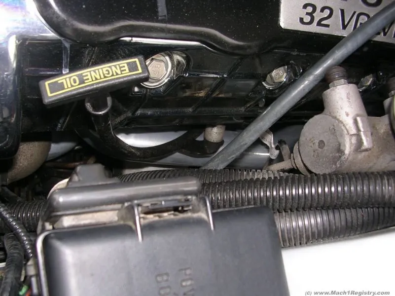

Motor is back, they're rocking n rollin on the car now. I'm swapping on a set of chrome valve covers. They painted the timing chain cover black. Basically making it look nice. Rep from Diablo will be in town to help tune this weekend and they are going to work hard on finishing up my car...I'm pumped.

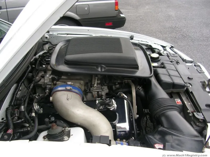

It's no much to look at, still looks stock, but that all goes out the window as soon as I fire her up.
I def need some more dressy bits in the engine bay to make it look nicer.
And I def need to do some Mother's back to black on the shaker again, I hope to give her a nice wash and wax soon. It was pretty clean when I got her back but it rained some and I was driving around in it (couldn't resist).
Hope to have some videos as well. It def grabs attention everywhere I go now...almost too much.

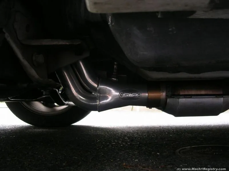

Those SLP's look damn nice... What are you doing on here? You have a break in period to fufill...
The SLPs are nice it's a shame the 4.6 DOHC is so damn big because they are really nice to look at. The motor is already broken in, the shop made sure it was done properly.
I do however need to still get a Kenne Bell boost-a-pump as the stock unit is losing pressure past 5500 rpms so I plan on taking care of that in a few weeks because prolonged high RPM blast could result in a lean condition when fuel pressure is cut. But I'm just having some fun right now, putting some miles on it for the time being then I'll take it back. These cams pull well past 6500 rpms, going to have to get some intake work done in the future.
