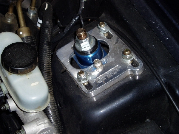

How much are you able to lower your car before caster chamber plates are required?? I own a 2002 GT coupe, any info is great.
thanks.
p.s. I was looking at the Eibach pro-kit lowering the vehicle 1.3-1.6''.

I believe that 1.5" is the limit before you need them. Once you go over 1.5" you will have to redesign/replace the whole suspension so I do not think it is worth it to go over 1.5" IMHO.

Would it be nessecary to use caster chamber plates if you are installing the pro kit??

Generally no. but nice to have one

I have pro-kit springs and am not in spec, so I purchased some MM CC plates. I did however remove the front isolators and replaces them with thinner rubber peices, but that doesn't make a huge difference.

I needed CC plates after installing my Eibach Pro-Kit springs. Just get them.

doi it right..get the cc plates
i had the pro kit on my car for about 14 months with our the cc plates..eventually i was getting some uneven and ugly wear on my tires as a result of a poor alignment becuase the car was lowered
it's just not worth it not to get them.....
