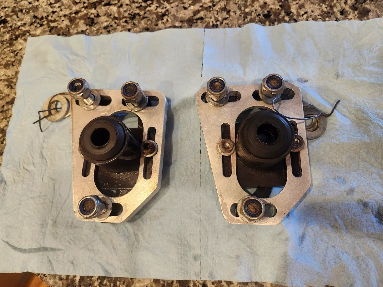

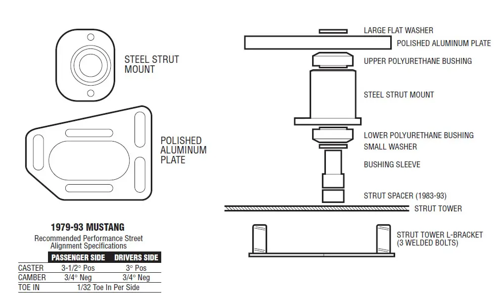

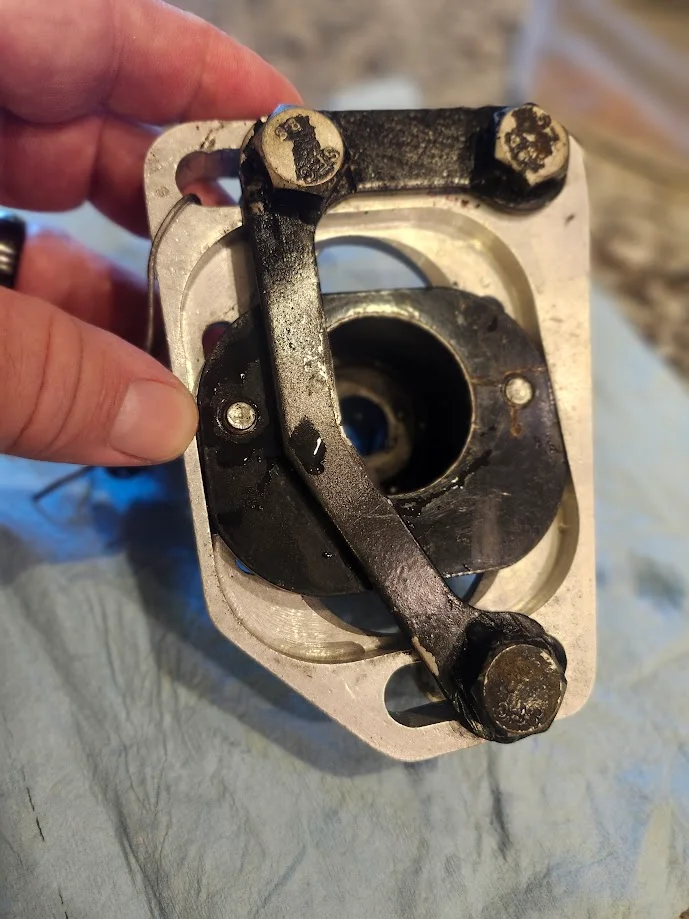

I picked up these CC plates for pretty cheap, but I may have made a noob mistake. Are they missing the sleeves and lower bushings?

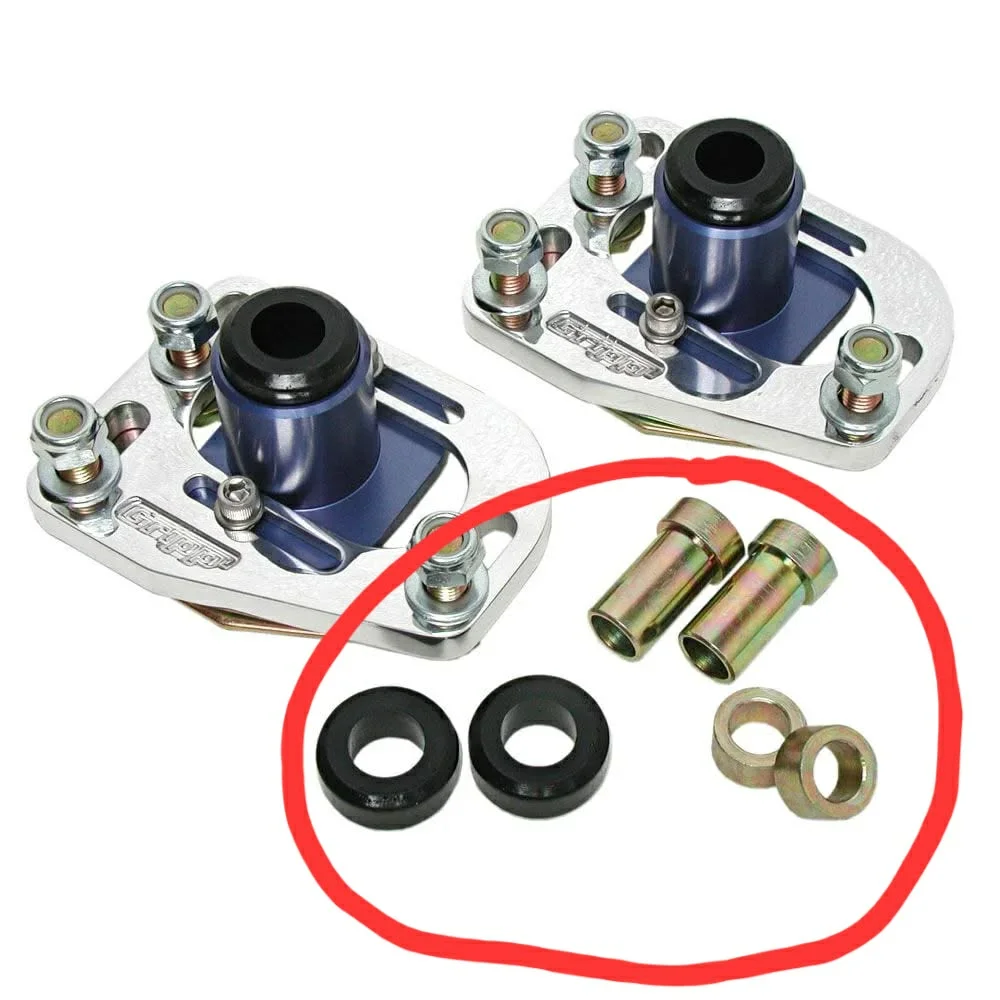

They're unmarked, but look identical to the BBK 2525 plates. There's a hardware kit available for the BBK's. Any reason those won't work for mine? Are there any measurements I can get to cross reference?
Even if I have to get the kit, I'm still in for only ~$100.
