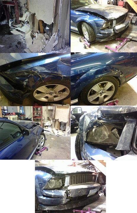

Here you can see the impact it took and how well it held up!
