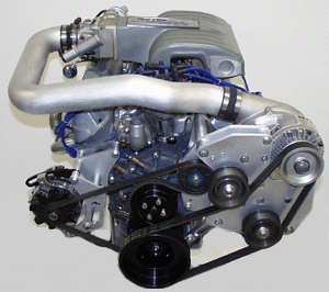

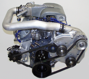

So does the blower mount on the drivers side? That is what a renegade kit is. It allows the discharge tube to come straight out instead of having a 90* bend. I also has a stronger components and a more agressive impellar. You also wouldn't have AC or power stearing.
Here is what it would look like:
As for the car making low boost it could be numerous things. The BOV could be leaking boost out, or maybe the bearings in the blower are going bad. Have you had the car on the dyno? Is it really rich at WOT?
