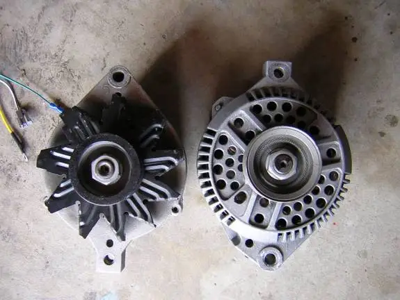

Ok.. Ill start by saying it may be just in my head but it seems like my (92. 5.0 5 speed) idles slightly higher now.
For the swap. I...
Used 94 v6 alt,
Used the premade harness from eBay .
Ran a 4g fused power wire from the alt to the solenoid.
Ran a 4g ground wire from the ground by the battery that the computer uses and ran it to front of block.
The only thing I didn't do was run a new one at the rear to the firewall ( original is in place)
Like I said.. It may be in my head but it felt different...
Thoughts?

Just a quick update. I stopped by my local sears hardware. They had the part I think I needed. I took the 2g spacer and found the same thing only thinner. It's called a "spacer bushing". Ill test fitment tonight.
