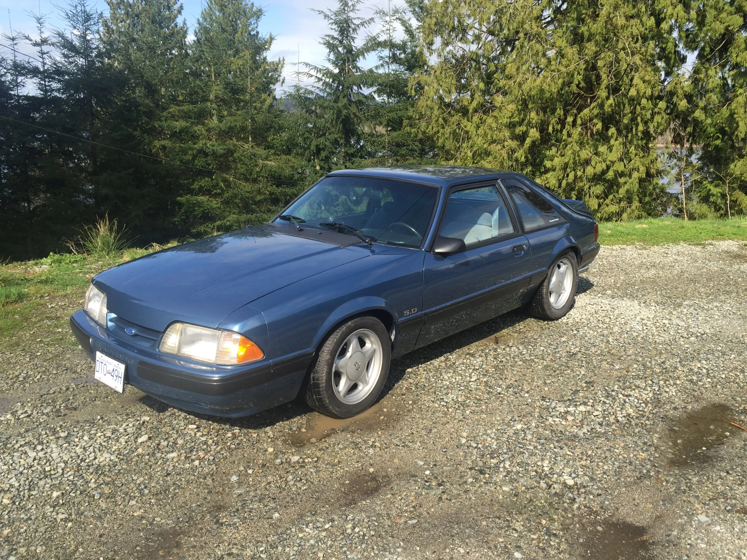

All great input... thanks everyone... I agree, even though it's not that bad... may be just better to find an auto car... this one is so damn clean though...
