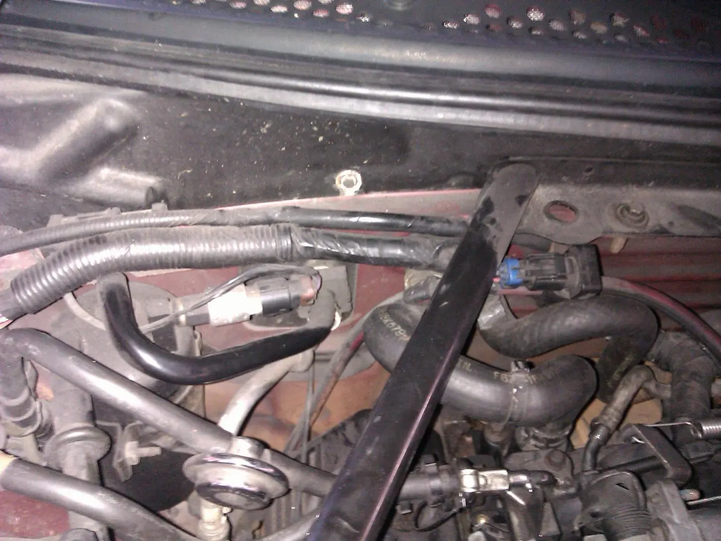

Can anyone tell me which one is the purge flow sensor in this picture because i keep getting the same code in my mustang? I am confused because one post says it's behind the fender liner and another post says it's near the firewall on the passenger side.

darkhorse96:
See that connector with the blue butt near the middle-right of the photo? That's the flow sensor - it's in the rubber tubing that goes to the manifold (or throttle body). The canister is in the fenderwell behind the plastic liner.
HTH,
Chris
The Duralast PV342 purge flow sensor is a great place to start. Also suggest replacing all of the EVAP vapor lines from the the throttle body back. Gas vapors are very hard on rubber parts. This makes the line rot out from the inside.
A bad PF sensor and a bad solenoid will throw the same DTC code. Suggest performing a functional test of the purge solenoid at the same time. With no power, you should not be able to blow through it. Once 12 volts is applied, you should hear a click and then be able to blow through it.
