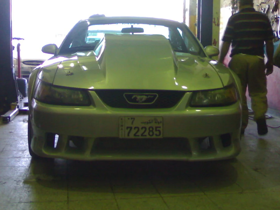

1 inch cowl like this? :D
:lol: I am not sure if that is 1" or a little less.....
