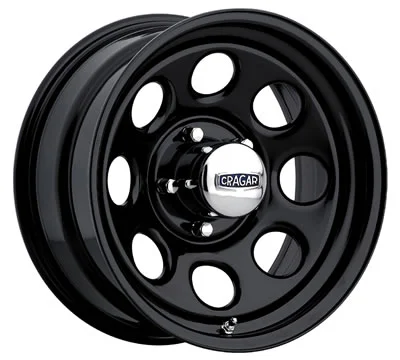

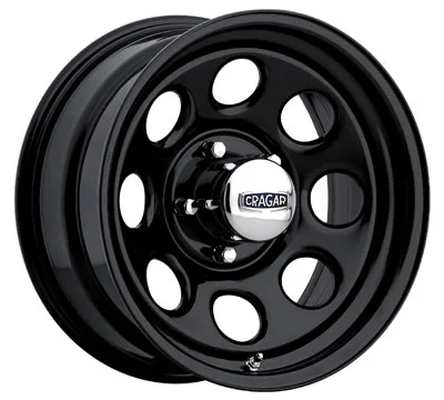

2 for 84 shipped lol :lol:
Here's the specs
Brand: Cragar
Product Line: Cragar Black Soft 8 Wheels
Rim Diameter (in): 15 in.
Rim Width (in): 8.00 in.
Backspacing (in): 4.750 in.
Offset (mm): +6.00mm
Rim Material: Steel
Center Material: Steel
Wheel Finish: Black
Beadlock Functional: No
Lug Nut Seat Style: Conical seat
Wheel Construction: 2-piece
Beadlock Included: No
Conical Seat Taper: 60 degree
Hub Centric: No
Center Bore Diameter (in): 3.300 in.
Center Cap Included: No
Valve Stems Included: No
Quantity: Sold individually.
Pic
There's a guy over mod depot that was running only a 4.5" backspace on 99-04 gt and had no rubbing, so 4.75 should be fine for a 15x8, and they are cheap.

Hahaha. Killer dude. Might take a look at this though, lol.
Same wheels I have on my Jeep...:nice:
Mine have a little less backspacing though.
Where did you order from though? 2 for me shipped would have been around $65-70.
I got them from Summit about a year ago or so. They may have bumped them up a few bucks, no biggie.
jivepepper- I didnt mean they werent good looking wheels (cause I think they are, that and price is why I got em) I just thought it was funny that they are primarily a 4x4 wheel. Im sure they will work great for you, ive seen the "d window" (same thing, cept the holes are a D shape, not round) on fast cars before. Good purchase.

I know you meant nothing by it.:D
