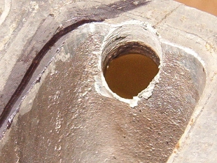

I'll post the pics tomorrow, the casting flash around the injectors holes is amazing, personally I would have taken care of that before it even made it to the car for fear of it breaking off.

Here's a pic of the slag at the injector hole
