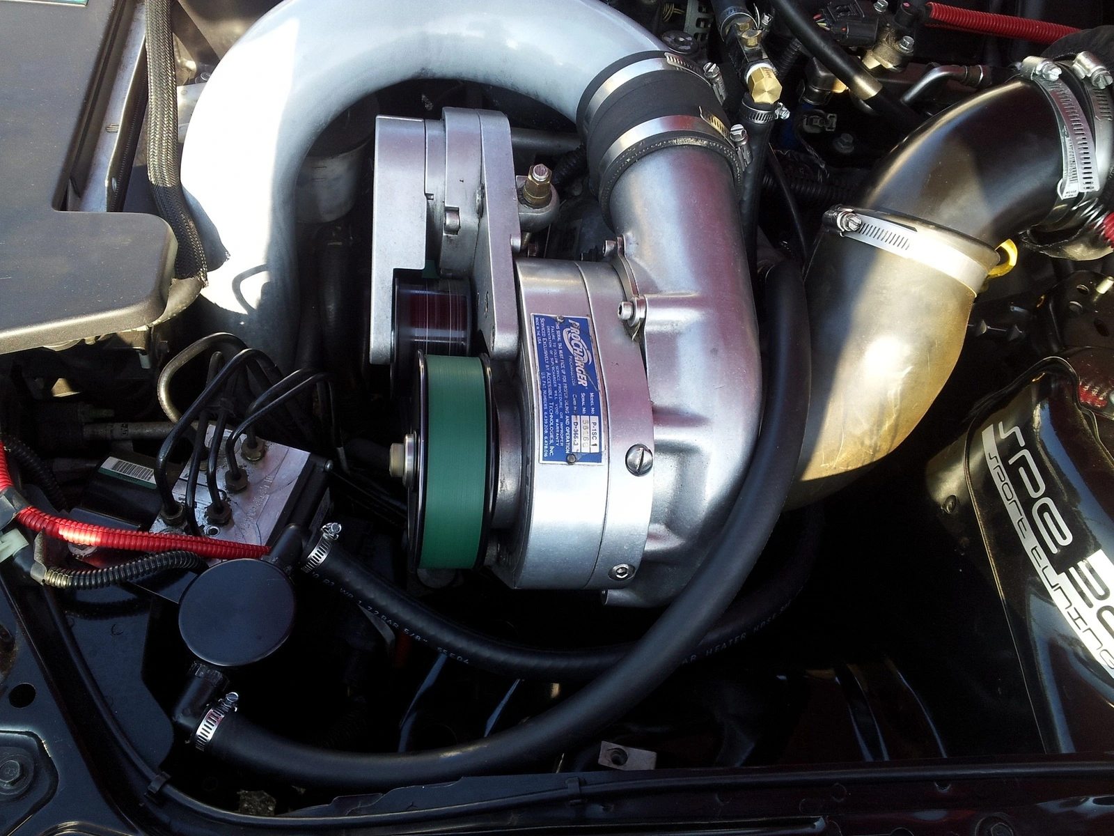

this how I installed the catch can is this the corret way
The thing you are concerned with is a vacuum leak. Looking at the picture, I cannot see a problem, but that doesn't mean one isn't present.
The easiest way to find a vacuum leak is to spray carburetor cleaner on and around any area you suspect might be leaking, or could possibly leak and watch the oxygen sensor output. The oxygen sensor output will drop to around zero volts and the short fuel trim will also reduce or even go negative if a leak is present while you spray carb cleaner on it. Listening for a change in engine RPM can also be done if you don't have a capable scan tool, but this is not a very reliable method to find smaller leaks.
