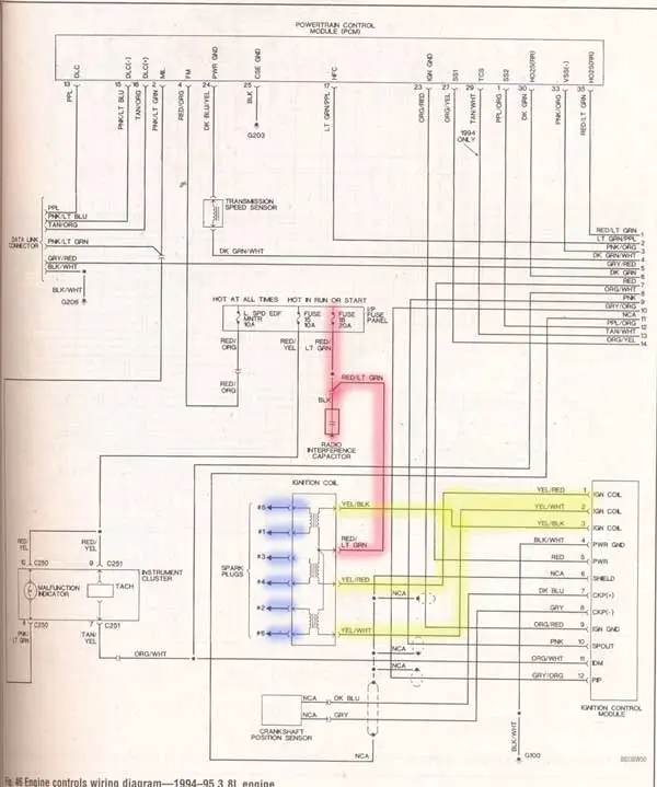

Same Problem again......sucks...... I got a new ignition coil in, and new plugs, and still having the same problem. And fuse 18 still keeps blowing. Fuse 18 says it's for CCRM power, ignition coil, charging system warning lamp, and regulator signal. Well, at least that's what the chiltons manual says. In the owners manual I believe it says it's for the EEC like stated above......
I am attaching a scanned file from my Chiltons manual for the ignition coil wiring. I have high-lighted the wires comming off of the coil. The one in red is going to fuse #18 in the fuse panel inside the vehicle. The wires in yellow are comming off the coil going to the ICM (ignition control module) and the ones in blue are comming from the coil and going to the spark plugs. The #18 fuse inside the vehicle keeps blowing, and it's just going straight to the ignition coil. I'm guessing there may be a short somehow in the wiring from the coil to the fuse panel. I'm looking for any more advice thought because I don't want to rip my dash apart unless it's really needed to verify if the wiring is good or not. If nobody can view the attachment that well, I can rescan and resize the pic if needed.
