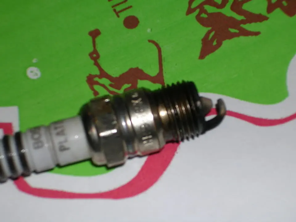

Check out my plugs guys!
bobbys9350
Mar 30, 2005
472
I pulled out those bosch platinums and put in some motorcrafts, when i pulled them i found that theyre looked to be a little whiteish. Aso there was oil on every one all around the base. whats up guys?! THANKS!!!
I was told that blowby will not cause plugs to get soaked with oil.. i just went through a similar episode. You may be looking at bad guides, valves, or valve seals.
For me, it was bad valves (excess play within the guides) allowing oil to pass down through the guides and soak the plug!
Your plugs are fine. You can't tell much from reading spark plugs after driving around normal and idling. Only true way to tell is make a hard WOT pass, then shut the car off at the top of the gear and coast to a stop, pull the plug right there and read it.
