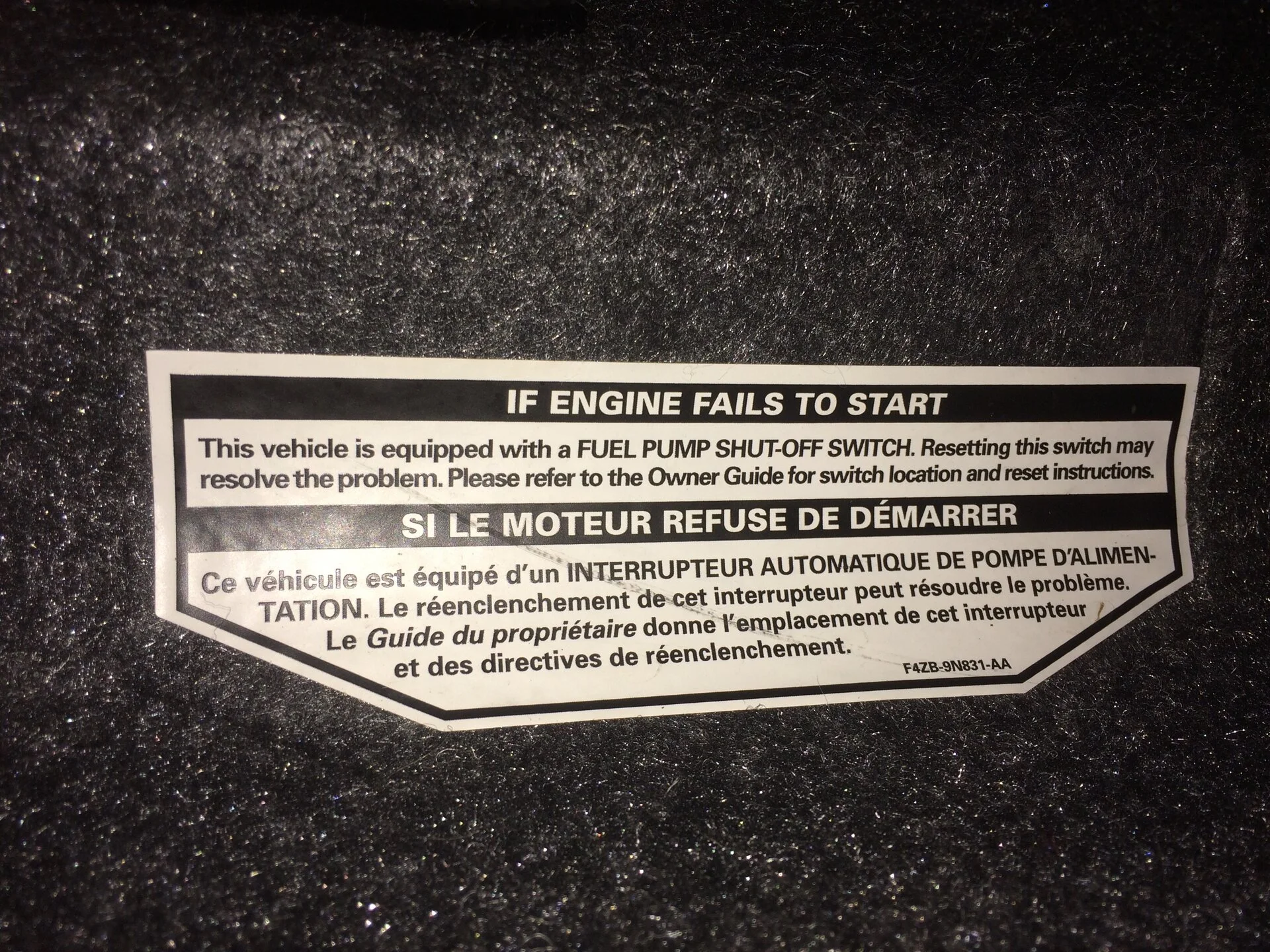

There is a fuel pump switch, sometimes called an inertia switch located at the back of the trunk on the drivers side.
You might push the reset button in case it inadvertently got activated. This is a pic of where mine is, 02 GT.
