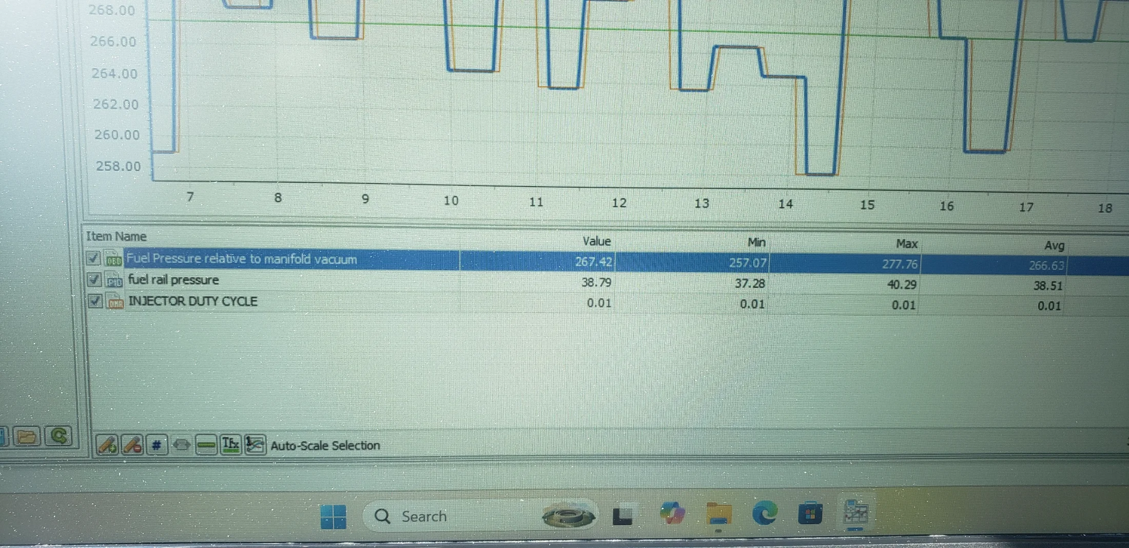

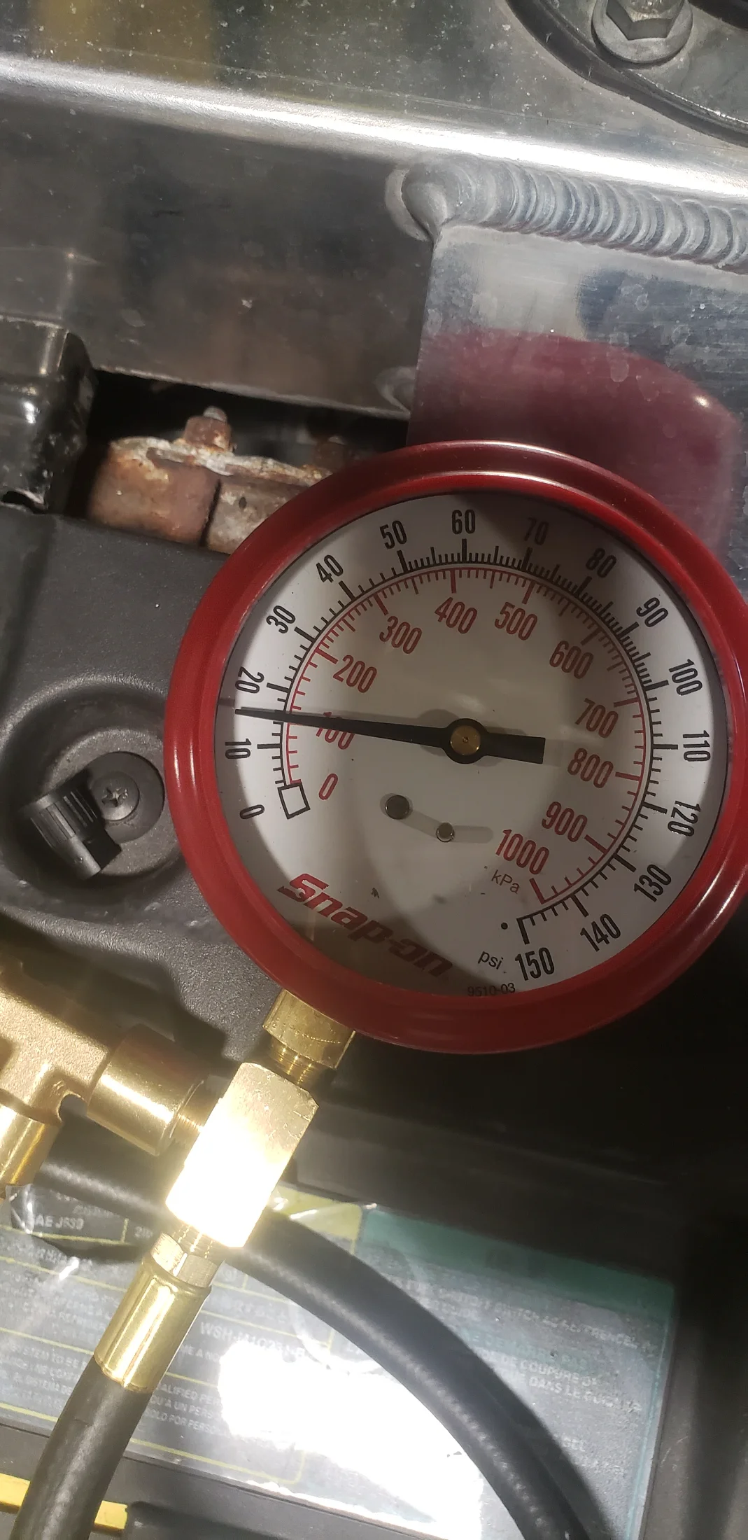

Hi all. First post here. I have a 2003 cobra. I installed a 2.3 whipple, 60 lb injectors, maf. Car was previously tuned with a chip which I had removed. Using an sct tuner to get tuned. Tuner said he had to add a bunch of fuel to the base tune. (Very reputable tuner). Decided to check fuel pressure at the rail. 14psi. Makes alot of sense as to why he had to add so much fuel. I drove the car for 2 years without issue. I check fuel rail pressure pid using laptop and sct x4. Fuel pressure reads 38-40. Exactly what it is supposed to be. At the moment I'm confused and not sure where to start checking. Idles at 14-15 afr. Any help would be greatly appreciated. What to get this thing running properly asap
Ok, thoughts:
The mechanical pressure gauge [could] be bad. Did you remove the valve stem from the rail when you hooked it up?

Thats what im thinking. I replaced fuel filter, fuel pumps, frps, fpdm. No change. Checked the voltage going to the fpdm and 14v. Checked voltage at pump connector. 14v. 3.5v voltage drop across the pump.as it idles. Everything is checking out ok. Dont know what else I can do on my end. I hooked up the boost a pump as the instructions directed and got 80psi at idle. Disconnected again.
