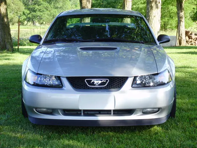

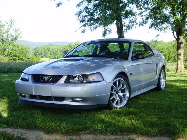

the H&R SuperSports gave the car a really nice stance but i wanted just a hair bit of a rake and a tad less front fender gap. i decided to pull the front isolators, top and bottom ( energy suspension poly iso's ). measured before and measured after - right at a 1/2" difference, exactly what i was looking for. before putting the springs back in place, i cut a bicycle inner tube into short pieces to use on the spring pig tails. no squeaks, no noise, no harsh ride.
the chin spoiler is a Xenon from LMR. fitment was very good and seems to be a durable piece. this was a gift from my gf ( she has good taste :) )

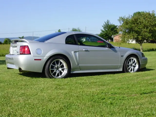

Looks great. You considered moving your wing back? A shorty antenna would be a nice cheap upgrade too.
i actually have been thinking about doing that. all the holes are still covered by the wing when you do this, right?
somewhat hard to tell in the pics but i already do have the shorty antenna.
yes all holes will be covered up when doing this.....unless you hang the wing like 4" off the decklid lol...
