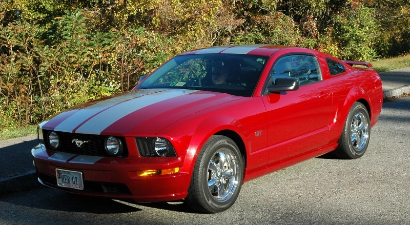

We just bought our 2008 GT in June and while we love it, we have both ("Wife Unit" and I) remarked about the excessive fender gap at the top of the rear tire as compared to the front. We also noted the rake front to rear, we think it looks better more level and I have shown her many pics of others on the forums.

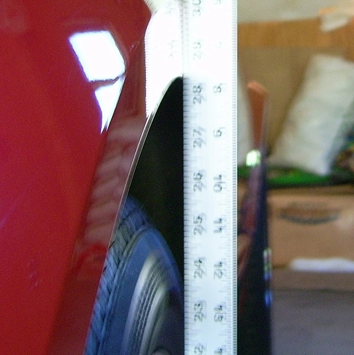

10-18-13 I did all that one must do to safely remove and cut and reinstall our 2008 Mustang GT's rear springs. This morning before I started I again measured the distance at each fender opening from carport to top of fender arch at maximum, fronts were 28-1/4" and rears were 29-3/8". My goal was to eliminate at least 3/4" in the rear and not need a panhard bar change.

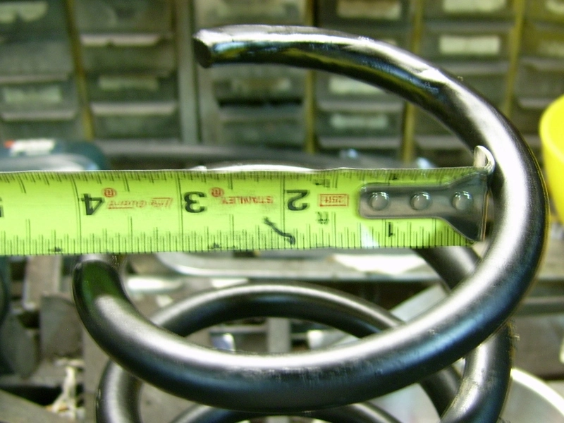

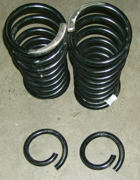

I cut using a Dremel with a fibreglass HD cuttoff sheel, the wheel shows minimal wear. I read of people worried about heat .... and often resist the urge tpo respond. The spring end last half inch got a little bit warm, but not even uncomfortably so, the cut is so small and narrow and weighed against the mass of the spring, does not get the steel hot. I cut one full coil off the top end of the coils plus an inch which was where I marked using a 1" wide rule against the spring end.

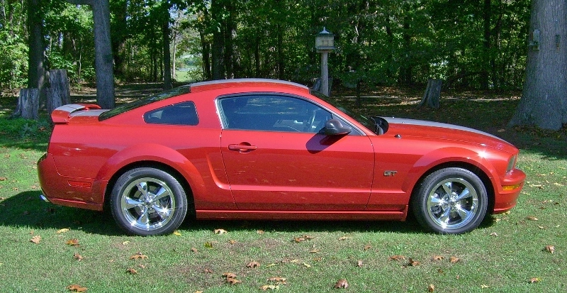

After I was finished, I took a short drive and then I measured again in the same spot on the carport, and I am glad I did not cut more! Imagine my surprise to find that now all four fender tops, front and rear, are each 28-1/4" from the floor. All 4 the same, and just a hint of rake along the lower edge of the rocker panels.

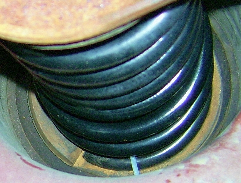

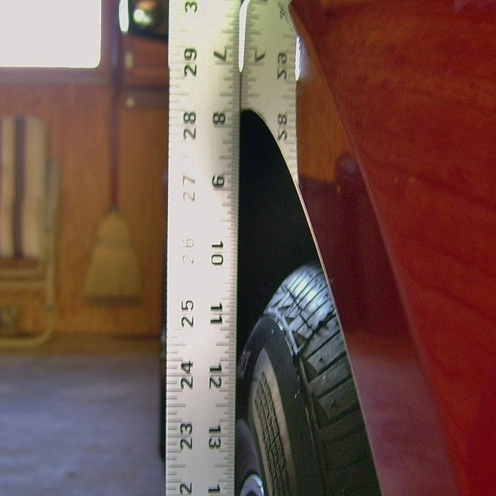

I was curious to see if I needed to work any on the panhard bar, had decided if within 1/4" I'ld leave it alone .... with a straight edge from fender down to tire sidewall bulge (rear tires at 33 psi) the gap to upper sidewall is "ever so near the same" (even if pic is fuzzy).
On 10-19-13 I decided to double check my side to side centering with a level and plumb. I was pretty sure it was OK but I had already (before even yesterday) decided if I found it off much, instead of an adjustablle PHB, I'd just move the stock hole a little bit on one end (example being that if one side had been 1/8" more or less than the other, 1/16" movement would correct it).
I placed a level across the spoiler top and found it level, checked carport floor and it was level under rear bumper, so I hung a short string with weight from each fender top at center and measured from string to tire sidewall .... driver's side just a hair under 3/8" but over 5/16" (about 11/32"), passenger side right on 3/8" mark (12/32") and that's "pretty darn close" to being the same.
I guess that the yard stick pictured was closer to 1/4" each side because the bottom of the yardstick was against the sidewall which appearantly had less bulge at 33 psi .... less than 3/8" bulge anyway so that yardstick was angled inward from fender lip some little bit.)

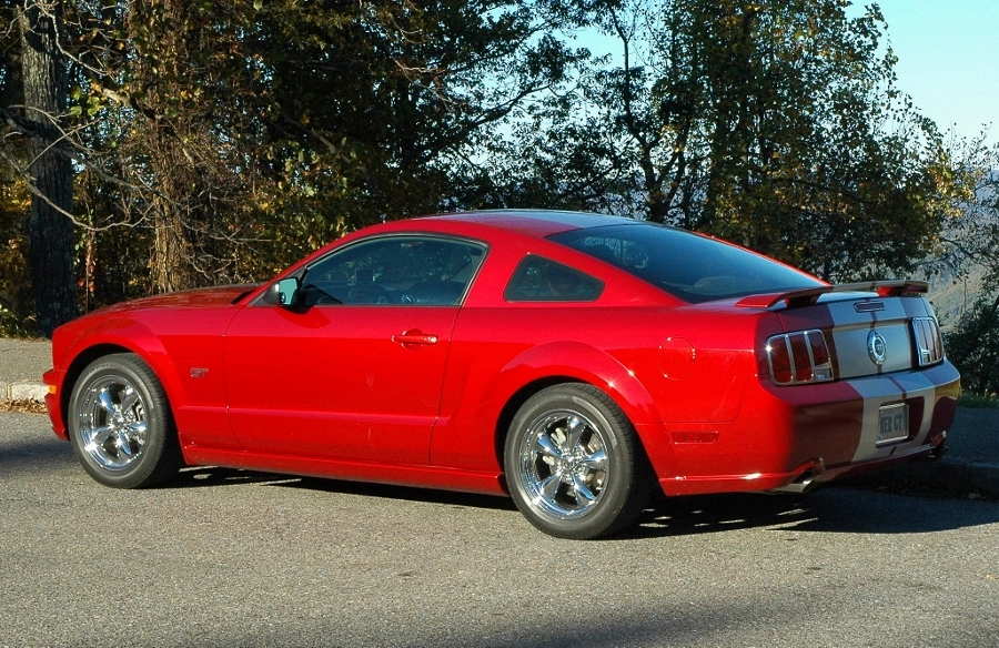

Before:

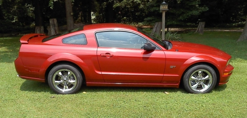

After:
I think it looks great, certainly worth the time spent and $$$ saved which is like "earnings" as opposed to what I would have done had I won that bid ....

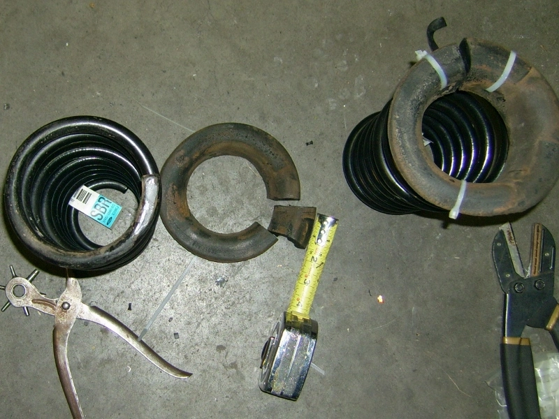

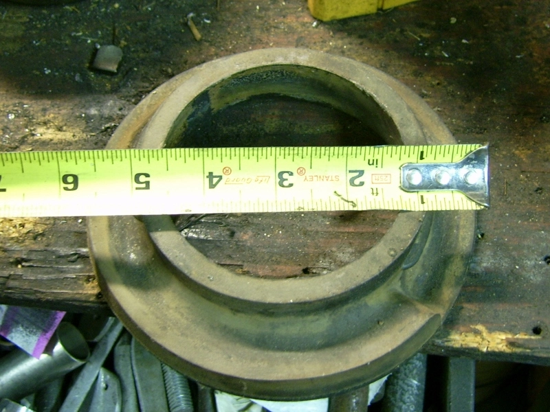

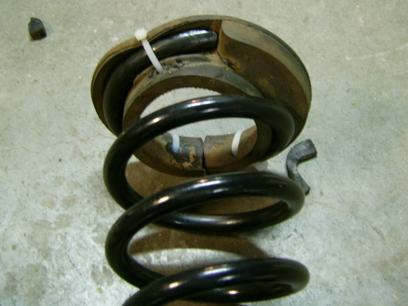

10-22-13 ...... while delivering parts I had some time to think and suddenly I recalled a bunch of 89-97 Thunderbird rear spring rubbers I had in a box, and they have a built in ramp and step to seat a coil with open ends.
I got home after work, pulled the Mustang around onto ramps, jacked and set frame on padded stands, and removed ramps and undid lower shock bolts and eased axle down with jack and removed the coils I had cut a few days ago. No permanent bends yet and we drove them over 250 miles Sunday alone on a not smooth roadway.

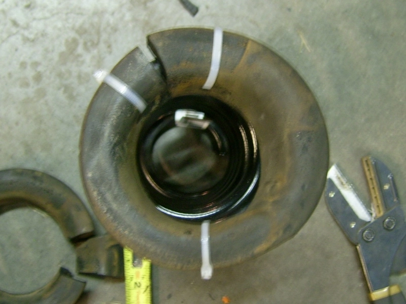

Mustang springs are about 3.5" ID, the T-Bird springs in a 89-97 Thunderbird rear are about 4" ID, the rubber snap into the coils. I modified them a bit .... cut a section out where the two tie wraps are closest. I then reinstalled the springs with the pigtail part of top towards rear of car, centered in spring seat with new T-Bird rubber between spring and Mustang Rubber with center bumper.
Where immediately before todays "spring seat rubber" mod the top of the rear fender arches were 28.25" from floor, afterwards they were nearer 28.5" .... a gain of just under 1/4". That's still a good full inch below where they were and that's OK. I was looking through pictures from Sunday, with camera gear and tripod and tool kit and stuff in trunk, the rear was maybe 1/4" low anyway?
